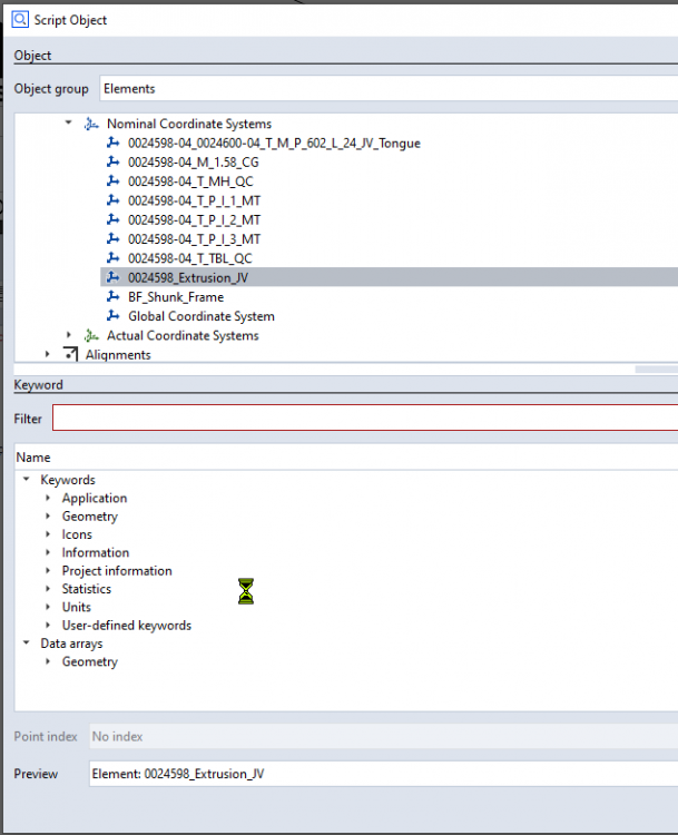

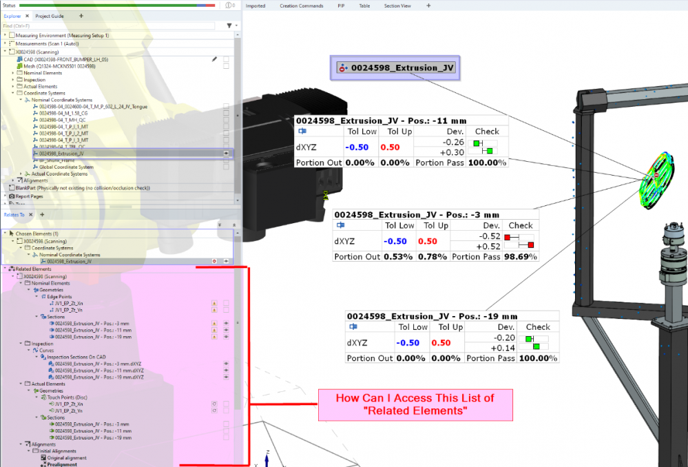

ie. lets say I have a Local Coordinate System with a few dependent elements.  Is there a way to access those related elements in the script editor?
I've searched through all the keywords and wasnt able to come up with much.
Some Pictures Below to help clarify:

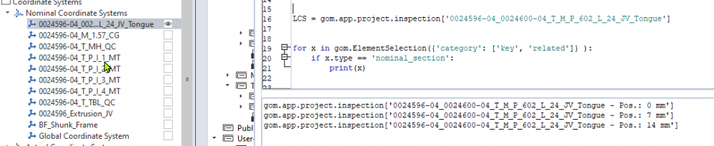

That's exactly what I'm looking for !!  & seems to work perfect if I have the element selected in the explorer.
but in a normal script/program I'm not going to have that element 'selected'.
can I pass a specific element into that gom.ElementSelection function?
eg. I'm trying to find all nominal sections related to coordinate system 'LCS'
I tried to print( gom.ElementSelection.__doc__ ) but it returned None =(
Unfortunately, that is currently not possible. The wish to do that is recorded in our internal ticket system, but I cannot tell you if and when it will be implemented.
However, you can use this command to explicitly select an element via scripting:
gom.script.explorer.apply_selection(selection=[gom.app.project.inspection['LCS']])
