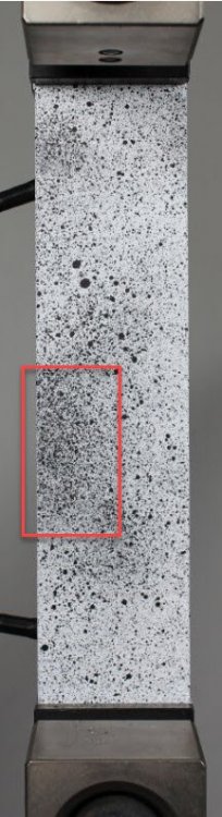

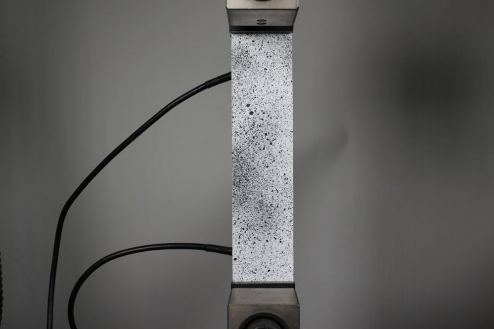

[ya...] Posted December 12, 2020 Share Posted December 12, 2020 I am researching crack width in reinforce mortar with carbon fiber samples. I'm straggling mapping the thickness of the cracks. It microscopic cracks. I wonder if with the photo resolution I use is enough? I have attached an enlargement of the crack in the software GOM. I would really appreciate if someone can answer me. I attached one the original photo that im import to the analysis and enlargement with "zoom in" for you to see the quality of the crack and if I can measure the width. Link to comment https://qualityforum.zeiss.com/topic/30-crack-width-in-mortar-sample/ Share on other sites More sharing options...
[Iv...] Posted December 15, 2020 Share Posted December 15, 2020 Hi Yarden, the resolution of your surface could be higher to measure more detail. You are losing a lot of pixel because you also measuring the area wide next to your specimen. I would recommend to rotate the camera through 90° and get closer. You are increasing the amount of pixel on your surface and so you can be more precise during the inspection. The next point you can improve is the stochastic pattern itself. If you get closer to your surface with your camera you need a finer pattern. You do have a good pattern style on the left side slightly under the middle space (s.attachment). I hope this input can help you to reach your measuring goal. Greetings, Ivan Link to comment https://qualityforum.zeiss.com/topic/30-crack-width-in-mortar-sample/#findComment-75 Share on other sites More sharing options...
