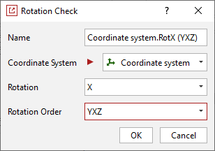

Hi John,
well, I think the best solution would be to get a rotation order parameter for rotation checks, but there seems to be not that much requests for such a feature yet.
On the other hand you can create python based value elements as User-defined Elements. There is still a bug which doesn't trigger an automatic update on any project change and the value element doesn't behave like a real check (it must be checked itself for it's value, it is not linked to the Local Coordinate System element, ...) but the data is generated/plotted/stored/edited in GOM Software anyway.
I will attach a package for such a rotation check (against global coordinate system always) for GOM Software 2020 and later. Please have a look into the code and adapt it to your needs.
Usage:
  • Drag&Drop the attached *.package file in your GOM Software (2020 and later)
  • Construct a Local Coordinate System
  • Run the package-script: SCRIPTING -> Script Choice -> Rotation Check
  • This will create a Value Element
  • Check this Value Element with the package-UDC: Value
BTW: F4/"Edit Creation Parameters" is enabled on the Value Element as on any other element type in GOM Software.
