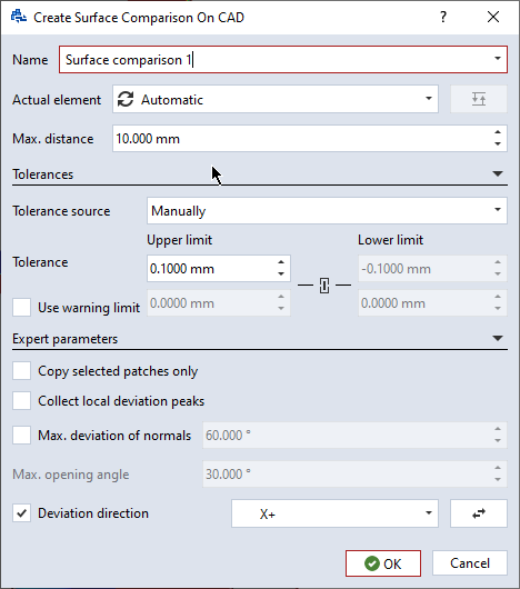

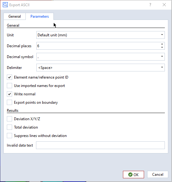

[Mo...] Posted June 18, 2023 Share Posted June 18, 2023 (edited) Hi, I am trying to export/extract value from surface comparison maps into .csv X and Y axis datapoint in GOM Inspect. there is a video tutorial in youtube, to extract values of surface analysis maps but only in 1 axis. could I do the same extraction but in X and Y coordinate? Cheers, Rais Edited June 18, 2023 Link to comment https://qualityforum.zeiss.com/topic/3019-gom-inspect-extract-2d-valuesdatapoints-from-surface-analysis-maps/ Share on other sites More sharing options...
[Na...] Posted June 19, 2023 Share Posted June 19, 2023 Hello Rais, you can either export the deviations of a surface comparison with X/Y/Z as Ascii (Export -> Geometry -> ASCII (parameters), or you create a surface comparison in a specific direction like X. This option is in the expert parameters of the creation dialog. Nanno Link to comment https://qualityforum.zeiss.com/topic/3019-gom-inspect-extract-2d-valuesdatapoints-from-surface-analysis-maps/#findComment-8023 Share on other sites More sharing options...
[Mo...] Posted June 20, 2023 Author Share Posted June 20, 2023 Hi Nanno Thanks, it is works, successfully export the X/Y/Z Data Cheers, Rais Link to comment https://qualityforum.zeiss.com/topic/3019-gom-inspect-extract-2d-valuesdatapoints-from-surface-analysis-maps/#findComment-8027 Share on other sites More sharing options...
