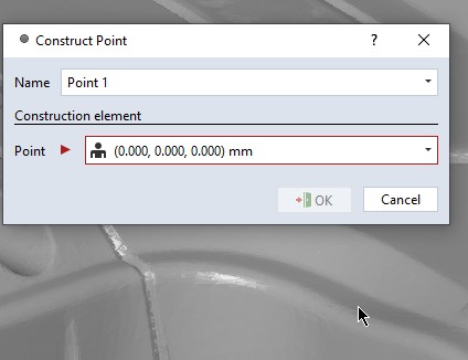

[Br...] Posted June 20, 2023 Share Posted June 20, 2023 Is it possible to construct a point (of any type) and then edit the coordinate to match, for example, an X=0, to align the point to an axis? I am seeing no way to perform this function. New user, so I am assuming user error is the issue 🤔 Link to comment https://qualityforum.zeiss.com/topic/3023-moving-point-by-manual-input-of-coordinates/ Share on other sites More sharing options...

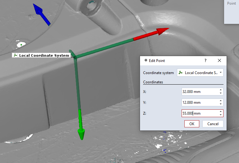

[Na...] Posted June 20, 2023 Share Posted June 20, 2023 Hello Brian, you can edit the Point with F4 or RMB -> edit creation parameters. Then click on "point" -> edit point. Editing the creation parameters requires the professional license though. Â Nanno Link to comment https://qualityforum.zeiss.com/topic/3023-moving-point-by-manual-input-of-coordinates/#findComment-8039 Share on other sites More sharing options...
[Br...] Posted June 20, 2023 Author Share Posted June 20, 2023 Hi Nanno, I do have a pro license, this is exactly what I was looking for, thanks! Link to comment https://qualityforum.zeiss.com/topic/3023-moving-point-by-manual-input-of-coordinates/#findComment-8041 Share on other sites More sharing options...
