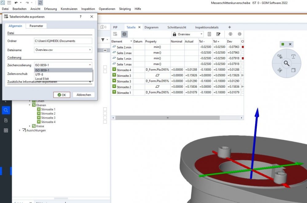

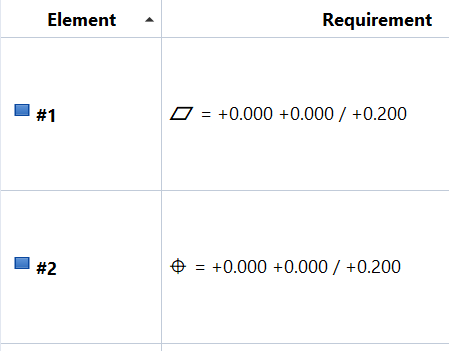

[Ma...] Posted June 29, 2023 Share Posted June 29, 2023 Hi What type of font is GOM Inspect using for geometrical symbols like flatness, position, etc? In GOM Inspect und PDF it looks ok: Extracting the values with Copy&Paste or Export to CSV it 's messed up: Copy & Paste [ = +0.000 +0.000 / +0.200 # = +0.000 +0.000 / +0.200 CSV Export ... #2.Position,Position = 0.000 0.000 / 0.200 regardless if I choose UTF-8 or ISO 8859-1 settings during export There are Unicode characters available, e.g. flatness U+23E5. Is there a way to use Unicode symbols instead? Thanks for any hint. Best regards, Martin Link to comment https://qualityforum.zeiss.com/topic/3043-font-used/ Share on other sites More sharing options...
[Je...] Posted July 4, 2023 Share Posted July 4, 2023 Hello mr. Ziegler, what kind of export are you using? Using .csv for example directly offers different types for further processing. Best regards, Jens Braun Link to comment https://qualityforum.zeiss.com/topic/3043-font-used/#findComment-8155 Share on other sites More sharing options...
[Ma...] Posted July 11, 2023 Author Share Posted July 11, 2023 Dear Jens, As written in my original post I tested this with UTF-8 and ISO 8859-1 without success. Would 8bit the way to go? Thanks & best regards, Martin Link to comment https://qualityforum.zeiss.com/topic/3043-font-used/#findComment-8215 Share on other sites More sharing options...
[Ma...] Posted August 18, 2023 Author Share Posted August 18, 2023 Update: Using the TTF font family Segoe UI instead of Arial helps for most characters, but unfortunately for all. Link to comment https://qualityforum.zeiss.com/topic/3043-font-used/#findComment-8579 Share on other sites More sharing options...
