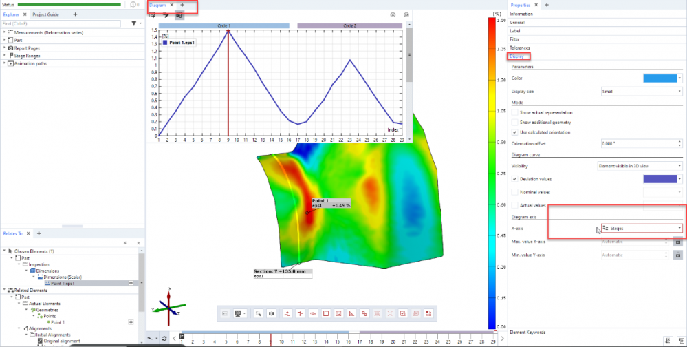

[Se...] Posted July 5, 2023 Share Posted July 5, 2023 Hello. I would like to have a graph of the strain in function of the gauge length [mm]. The gauge length is the length of the tested specimen (0 to 80 mm). Is it possible to have directly from GOM? Otherwise, would it be possible to plot the gauge length in function of the time or index? Link to comment https://qualityforum.zeiss.com/topic/3061-how-to-plot-strain-vs-gauge-length/ Share on other sites More sharing options...
[Iv...] Posted July 7, 2023 Share Posted July 7, 2023 Hello Serge, you can plot every scalar inspection into a graph. Check the image where to find it. You can also change the x-axis in the properties. If you like to change between index and time than click with RMB and change the timeline to the wanted info. Greetings Ivan Link to comment https://qualityforum.zeiss.com/topic/3061-how-to-plot-strain-vs-gauge-length/#findComment-8193 Share on other sites More sharing options...
[Se...] Posted July 10, 2023 Author Share Posted July 10, 2023 Thank you for your reply. Is there a way to set the x-axis as the length of the tested part? Link to comment https://qualityforum.zeiss.com/topic/3061-how-to-plot-strain-vs-gauge-length/#findComment-8209 Share on other sites More sharing options...
[Iv...] Posted July 14, 2023 Share Posted July 14, 2023 Yes. You have to create a 2-point distance with the 2 points at the edge of the surface. Inspect the distance in a specific direction. Set the X-axis to this inspection. Link to comment https://qualityforum.zeiss.com/topic/3061-how-to-plot-strain-vs-gauge-length/#findComment-8249 Share on other sites More sharing options...
