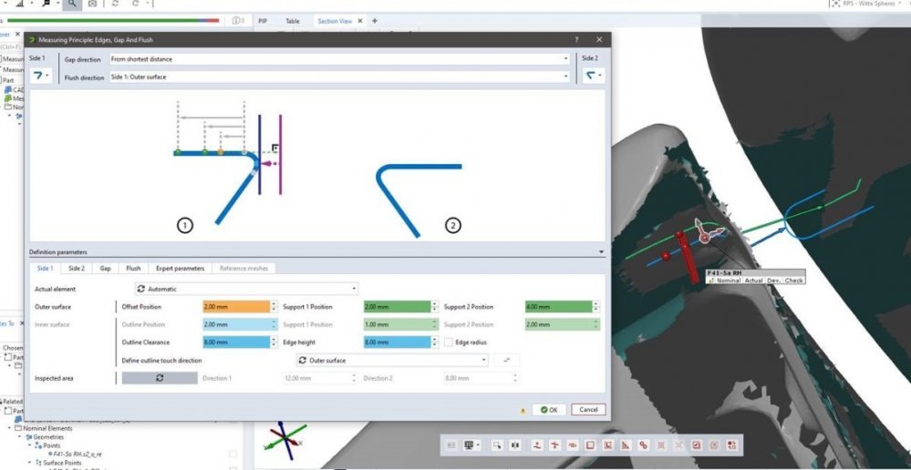

[Uz...] Posted July 25, 2023 Share Posted July 25, 2023 I am trying to measure gap and profile between closures. But is being projected to the B Surface instead of A surface – This could be due to Fender/Bonnet being out of position in ‘Z but there must be a way to control where the point gets taken. Tried various settings in G&F Principle but no luck. Link to comment https://qualityforum.zeiss.com/topic/3103-measurements-with-gap-rad-principle/ Share on other sites More sharing options...

[Na...] Posted July 27, 2023 Share Posted July 27, 2023 Hello, the measuring principle is described in the techguide article here: ZEISS Quality Tech Guide (gom.com) You can adjust the positions in the dialog and should see a preview/result in the section view tab. Nanno Link to comment https://qualityforum.zeiss.com/topic/3103-measurements-with-gap-rad-principle/#findComment-8370 Share on other sites More sharing options...
