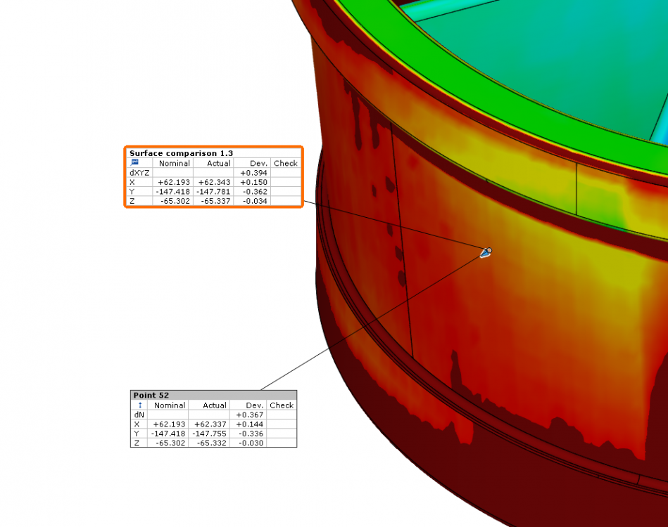

[De...] Posted July 28, 2023 Share Posted July 28, 2023 When DN Calculated on Surface point (Measuring principal Intersection with mesh/ Project on actual ) & on Surface comparison (On CAD) with the exact same coordinates why it shows different results. Is it possible to evaluate Surface Profile on surface created with selected points. Link to comment https://qualityforum.zeiss.com/topic/3114-coordinates-issue-in-surface-comparison-surface-point/ Share on other sites More sharing options...
[Be...] Posted July 28, 2023 Share Posted July 28, 2023 Hi, regarding 1: we are calculating for each vertex of the nominal CAD a deviation result. If you specify a point which is located on the surface an interpolation of all nearest point members are calculated (visualize the 'Mesh structure' on your CAD to get some information about the sampling of the CAD points). Furthermore the surface deviation is usually calculated as nearest distance to the actual surface data. 'Intersect with mesh' calculates the difference in the direction of the nominal normal which can also lead to a different result. regarding 2: You can create a 'Surface profile' on nominal patch compounds which are "linked" via point selection to a subset of the mesh data. If you edit the actual surface element you are able to modify the point selection to your needs. Hope this helps?! Regards, Bernd Link to comment https://qualityforum.zeiss.com/topic/3114-coordinates-issue-in-surface-comparison-surface-point/#findComment-8396 Share on other sites More sharing options...
