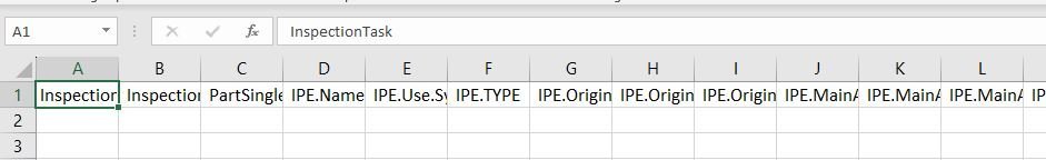

[Má...] Posted July 28, 2023 Share Posted July 28, 2023 Hello! I would like to create a BMW Ipp export. I imported geometries assigned measuring principle and check. First row has "description" data but nothing else. What settings shoul I check? Best regards, Máté Tömöri Link to comment https://qualityforum.zeiss.com/topic/3118-bmw-ipp-export/ Share on other sites More sharing options...
[Da...] Posted August 24, 2023 Share Posted August 24, 2023 Hello Máté Tömöri the BMW Ipp export only exports elements which were imported using the BMW Ipp import. Best regards Daniel Schrein Link to comment https://qualityforum.zeiss.com/topic/3118-bmw-ipp-export/#findComment-8627 Share on other sites More sharing options...
