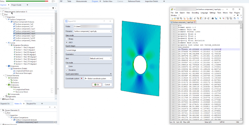

[Le...] Posted August 1, 2023 Share Posted August 1, 2023 New GOM user here. When I generate a strain field component, the spatially resolved overlay on top of my optical image is extremely useful. Is it possible to export a pixelated strain field component values as a .csv? Link to comment https://qualityforum.zeiss.com/topic/3128-exporting-pixelated-map-of-a-strain-field-component-as-a-csv/ Share on other sites More sharing options...
[Na...] Posted August 2, 2023 Share Posted August 2, 2023 Hello Lewis, you could use PLY (file -> export -> mesh) with checked "deviation" box: Link to comment https://qualityforum.zeiss.com/topic/3128-exporting-pixelated-map-of-a-strain-field-component-as-a-csv/#findComment-8428 Share on other sites More sharing options...
