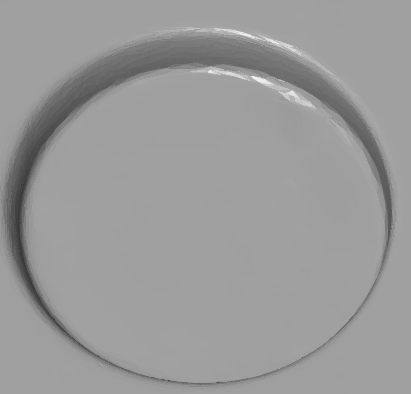

[Lu...] Posted August 3, 2023 Share Posted August 3, 2023 Hallo, wie kann ich die Tiefe dieser Nut messen, damit er mir das korrekte Soll anzeigt und es mit dem Ist vergleicht? Vielen Dank Link to comment https://qualityforum.zeiss.com/topic/3134-tiefen-abstand-messen-mit-referenzierte-konstruktion/ Share on other sites More sharing options...
[Di...] Posted August 3, 2023 Share Posted August 3, 2023 Hello Luca, I don't no if I undertand correctly the question but if you want to measure the depth you can make Plane on the botton and Plane on the top and see the distance between then. If this dosen't respresent what you want you can make a section our mutiple section that allow you to create a distance beteween lines our intersection points Link to comment https://qualityforum.zeiss.com/topic/3134-tiefen-abstand-messen-mit-referenzierte-konstruktion/#findComment-8444 Share on other sites More sharing options...
