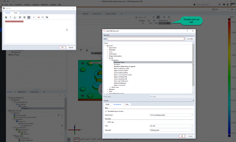

[Gá...] Posted July 17, 2021 Share Posted July 17, 2021 Dear all, Could you please recommend a good solution on how to export a 50 section actual results to a csv or excel file? Thanks in advance! Gábor Link to comment https://qualityforum.zeiss.com/topic/316-50-stage-actual-result-table-to-one-csv-or-excel-file/ Share on other sites More sharing options...

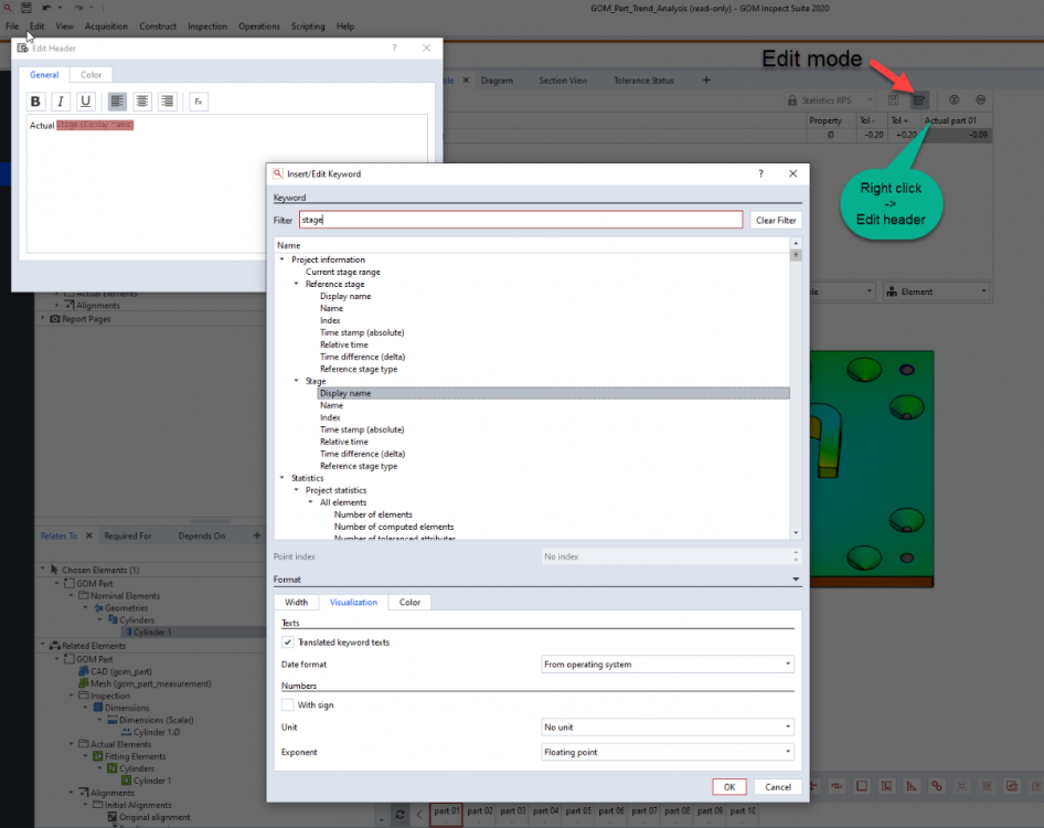

[Na...] Posted July 20, 2021 Share Posted July 20, 2021 Hello Gábor, you could use the table template "statistics RPS" as a basis and edit it to your needs. The headers show "dev" in this template, this can be replaced with the keyword for the stage name, for example. Instead of the deviation value you can enter the keyword for the actual value in the cell. This table can be exported as csv with the floppy disk symbol. Regards, Nanno Link to comment https://qualityforum.zeiss.com/topic/316-50-stage-actual-result-table-to-one-csv-or-excel-file/#findComment-916 Share on other sites More sharing options...
