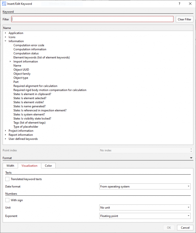

[Mi...] Posted August 16, 2023 Share Posted August 16, 2023 Hello! I am trying to update one of our GOM 2022 project templates and add the "Project Modification Time" keyword to a report page as I have done for other templates, however in the particular file I'm working in, that keyword (along with numerous others) appears to be missing? I tried to copy-paste it from a working project, but it only displays "Unknown Keyword" rather than the actual project mod time. Any idea how to correct this? I'm hoping the project hasn't been corrupted somehow as it took quite a while to put this one together. Thanks, Michael Henson Link to comment https://qualityforum.zeiss.com/topic/3179-some-default-project-keywords-missing/ Share on other sites More sharing options...
[Th...] Posted August 21, 2023 Share Posted August 21, 2023 Hello! Creating a new project that keyword seems to be unavailable in report labels but is available in labels in the 3D view. This is the same behavior in 2021, 2022 and 2023 versions. Could you please specify, which version works for you and which not? If you want to use this keyword in a report, you could add the keyword to a label in the 3D and take a snapshot of it as a workaround. Kind regards, Thomas Trentmann Link to comment https://qualityforum.zeiss.com/topic/3179-some-default-project-keywords-missing/#findComment-8599 Share on other sites More sharing options...
