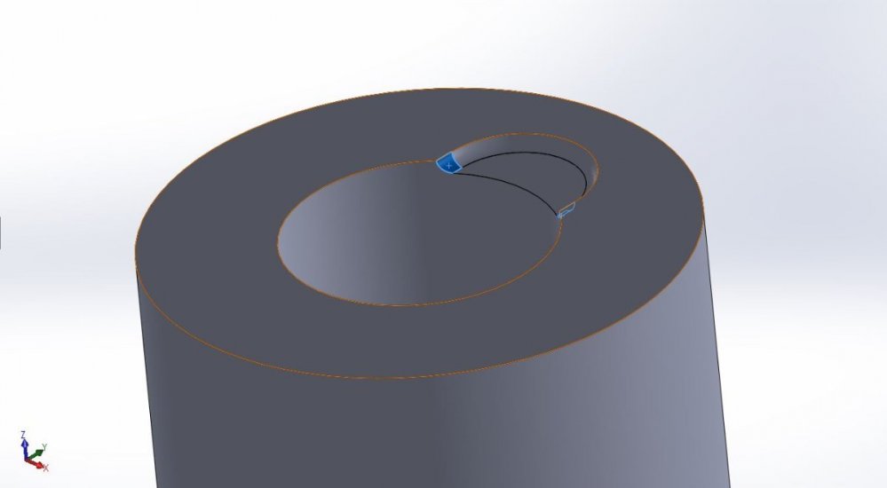

[Ti...] Posted September 14, 2023 Author Share Posted September 14, 2023 Below is an rough idea of the part I'd like to be able to create a circle on. This is a torus like cut out inside a part. I've sectioned the part so you can see better. The torus cutout in my real part is only 120 degrees, but here I'm showing 180 deg torus. Then there is a very small straight section in which I need to get the position of at MMC. I create a vector point on both sides to get the width. I tried to create a circle from the midpoint of both vector points and using one side point as the radius point, but like I posted it doesn't allow this for MMC. I convinced management to let me use the user defined checks to accomplish this so I'm good now, but it would be nice to be able to create a manual circle and apply the MMC to a positional check. Allowing variables for the tolerance in user defined checks would help as well. Link to comment https://qualityforum.zeiss.com/topic/3203-request-to-construct-a-circle-that-can-be-used-with-mmc/#findComment-8772 Share on other sites More sharing options...
