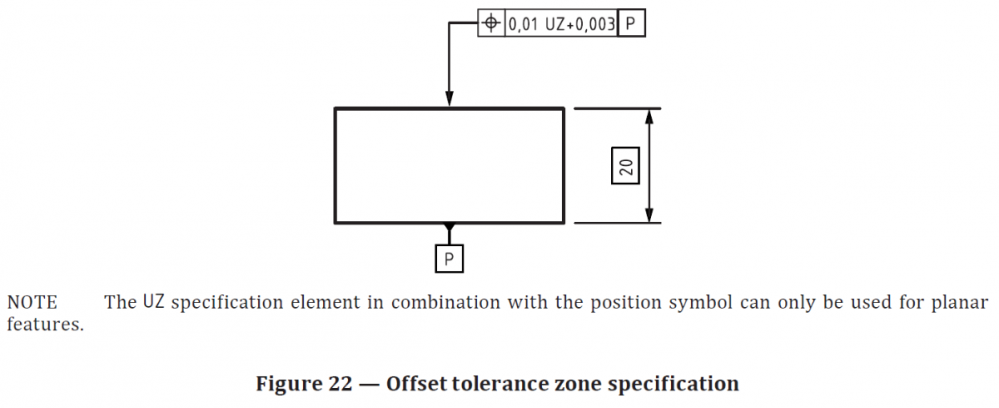

[Er...] Posted July 22, 2021 Share Posted July 22, 2021 GOM has implemented UZ (tolerance offset) for profiles, why not for positions? This would be very useful, since asymmetric tolerances are very common for planes. See below picture from ISO 1101 : 2017, Clause 8.2.2.1.3, page 19: Link to comment https://qualityforum.zeiss.com/topic/322-why-does-check-position-lack-the-the-uz-option/ Share on other sites More sharing options...

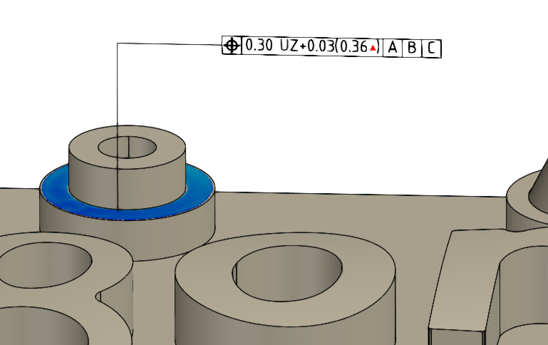

[Ch...] Posted July 23, 2021 Share Posted July 23, 2021 Hi, UZ option on position tolerances will be introduced with the GOM Software 2021 available this summer. Best regards Christoph Schult Link to comment https://qualityforum.zeiss.com/topic/322-why-does-check-position-lack-the-the-uz-option/#findComment-930 Share on other sites More sharing options...
