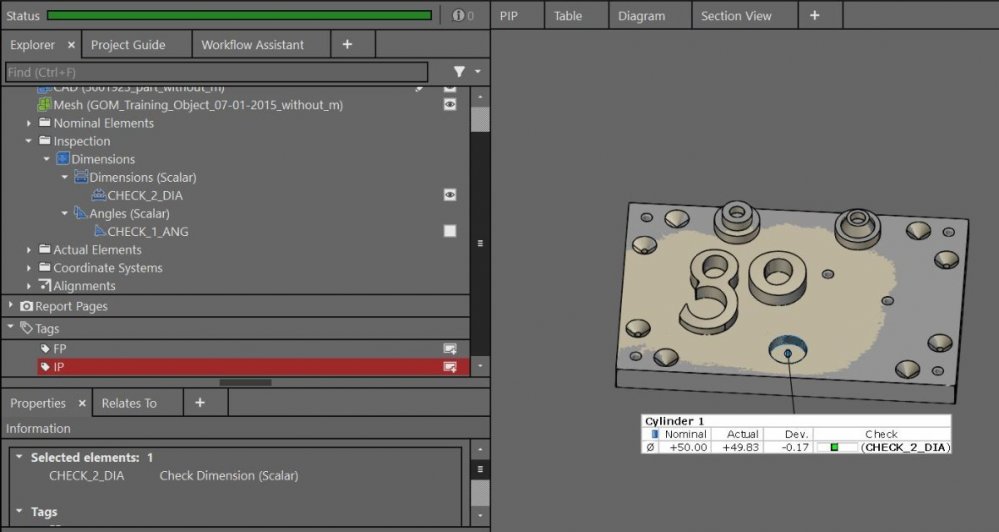

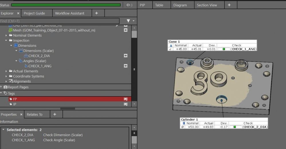

So I made some progress.
1) I highlighted two checks and hit 'T' for tag and named those 'FP' Then uncheck on of the checks and named that tag 'IP'
2) Seems you must click the little icon next to each tag to make a scene in the 3d view
3) Then I made two separate table report pages for each tag

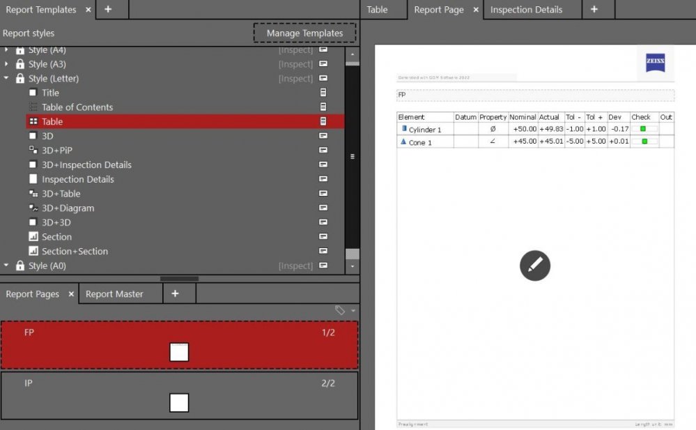

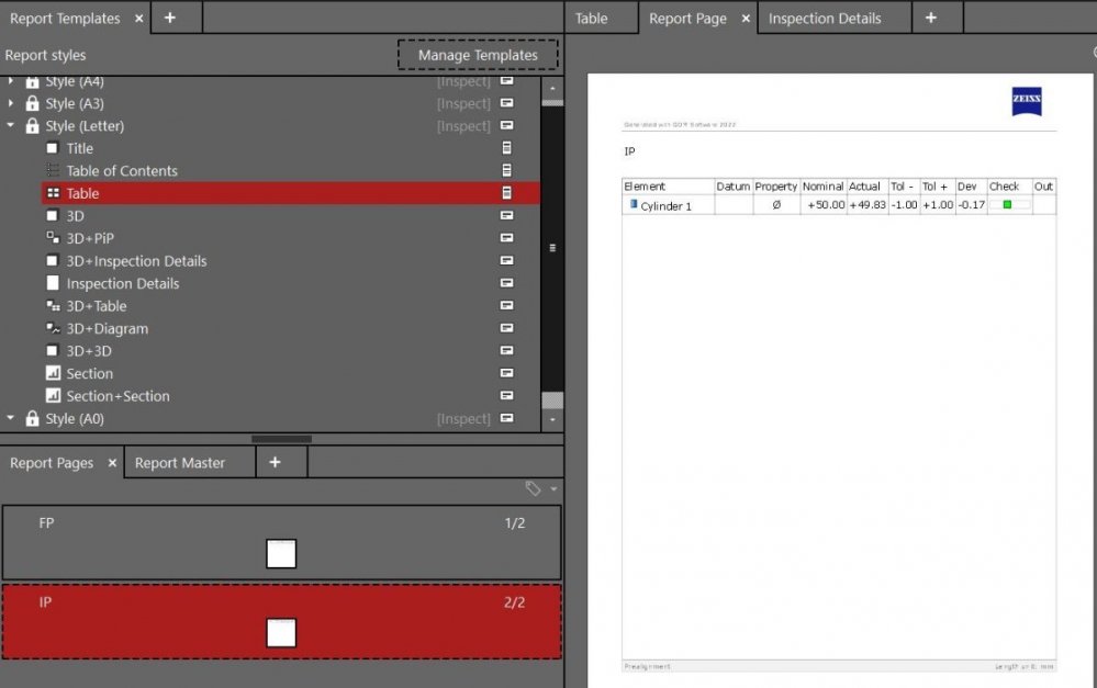

I think I got something put together, but not sure it is the most efficient. I've created two Title pages as one needs to say FP and the other IP. Both are tagged with FP and IP respectively.
Then I have my report page with the FP outputs tagged with FP and the report page with IP outputs tagged with IP.  Below is my setup now and my code that seems to be working. Is this what you had in mind?

Yes! This type of approach is in line with what i had in mind 🙂 it keeps the coding level manageable and the project can be manipulated manually afterwards if needs be.  Printed out an ip report but needed a full one...no problem !
Technically the items in those report pages do not need to be tagged as well, but i think its good practice , simply as you can navigate the project easier 🙂
