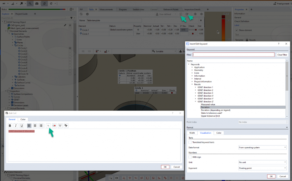

[Ba...] Posted October 16, 2023 Share Posted October 16, 2023 hello! I need to analyze the position of several holes relative to the reference, and I need the result in XYZ. When I change the display mode and retrieve the coordinates, no table displays the xyz coordinates and I cannot export them to .csv format. Only the overall deviation is visible in the table for all table types. Do you have an export solution please, because I wouldn't want to write the xyz coordinates by hand on excel, there are 1000 measurements to take... Thank you so much I also have another question, is it possible to display the XYZ Coordinates in polar? thank you Link to comment https://qualityforum.zeiss.com/topic/3331-xyz-datum-csv-export/ Share on other sites More sharing options...
[Na...] Posted October 16, 2023 Share Posted October 16, 2023 Hello, you could add this value to a customized table and export it to .csv. ZEISS Quality Tech Guide Nanno Link to comment https://qualityforum.zeiss.com/topic/3331-xyz-datum-csv-export/#findComment-9117 Share on other sites More sharing options...
