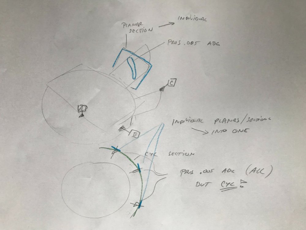

I am not allowed to share a DWG directly, so i tried to put some sketch together to demonstrate what i would need to inspect.
Attached picture is showing planar section (BLUE) of one individual blade, in specific DIA where this section requires the inspection of Line profile. Lets say i have 25 blades and i need to inspect Line profile of all 25 blades in this planar sections as a pattern/group in full datum SYSTEM ABC.
The easy way is to construct a cylinder (GREEN sections) based section on the same DIA as the plane must be located - section through scan - select all and compare NOMINAL section with ACTUAL. This is good - but i would need to replace that cylindrical section by planar (but for all 25 blades).

Hello,
i have found the way!
Lets create a planar section of one vane/blade and inspect it relative to GLOBAL CS.
Prior that, run ABC alignment and then use Best-Fit alignment based on ABC alignment, select all the vanes and allow the rotation along the B axis. You will have planar sections of all vanes (cluster rotation required) and all of those will be in the ABrot alignment (instead of locking by C).
Any feedbac for this approach?
