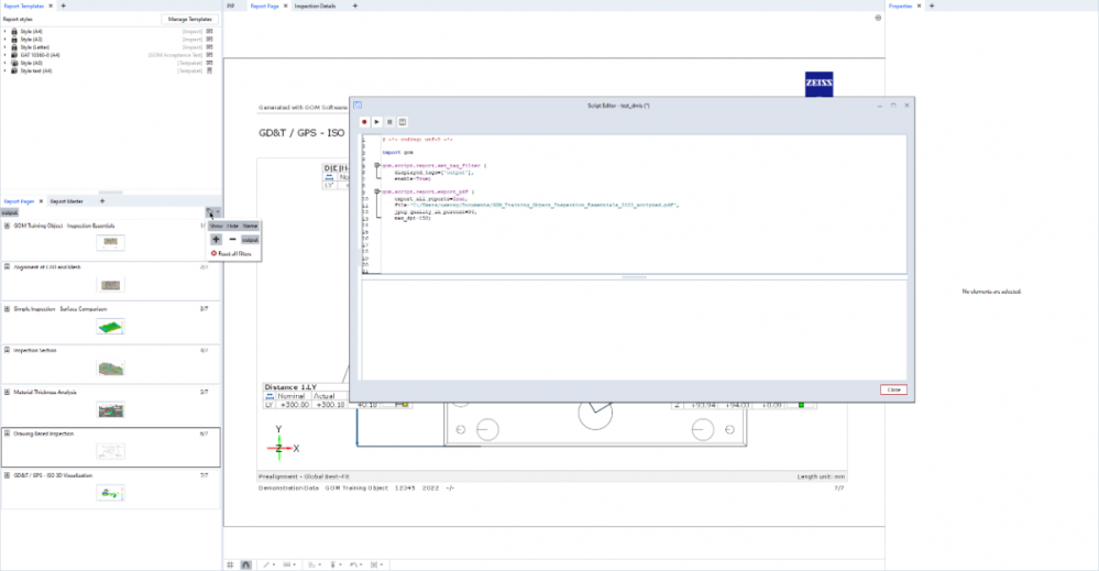

[Ti...] Posted October 31, 2023 Share Posted October 31, 2023 (edited) Im testing a new reporting strategy. Previously, we had a separate First part program with 100 checks and another in process program with 70 checks. I made one program now with a header page and 4 pages of check outputs for the First part, then another header page and 3 pages of checks for the in process. I then tagged each with separate tags. In python, if an operator selects in process I tell it to only output those tagged report pages. Works well except the pages start at 5/9 and end at 9/9. The program is assuming all pages are one big family when it would be better if they both started out at page 1/1. Is there a way to do this? Thanks. Please sign in to view this username. Appreciate the help earlier on this Edited October 31, 2023 name Link to comment https://qualityforum.zeiss.com/topic/3379-report-pages-and-tagging-reports/ Share on other sites More sharing options...
[Na...] Posted November 1, 2023 Share Posted November 1, 2023 Hi Tim, it works with "dynamic" page numbers if you filter the report pages by tag and then simply export all pages. Nanno Link to comment https://qualityforum.zeiss.com/topic/3379-report-pages-and-tagging-reports/#findComment-9321 Share on other sites More sharing options...
[Ti...] Posted November 1, 2023 Author Share Posted November 1, 2023 Please sign in to view this username. Beautiful, thank you! Works like a charm Link to comment https://qualityforum.zeiss.com/topic/3379-report-pages-and-tagging-reports/#findComment-9329 Share on other sites More sharing options...
