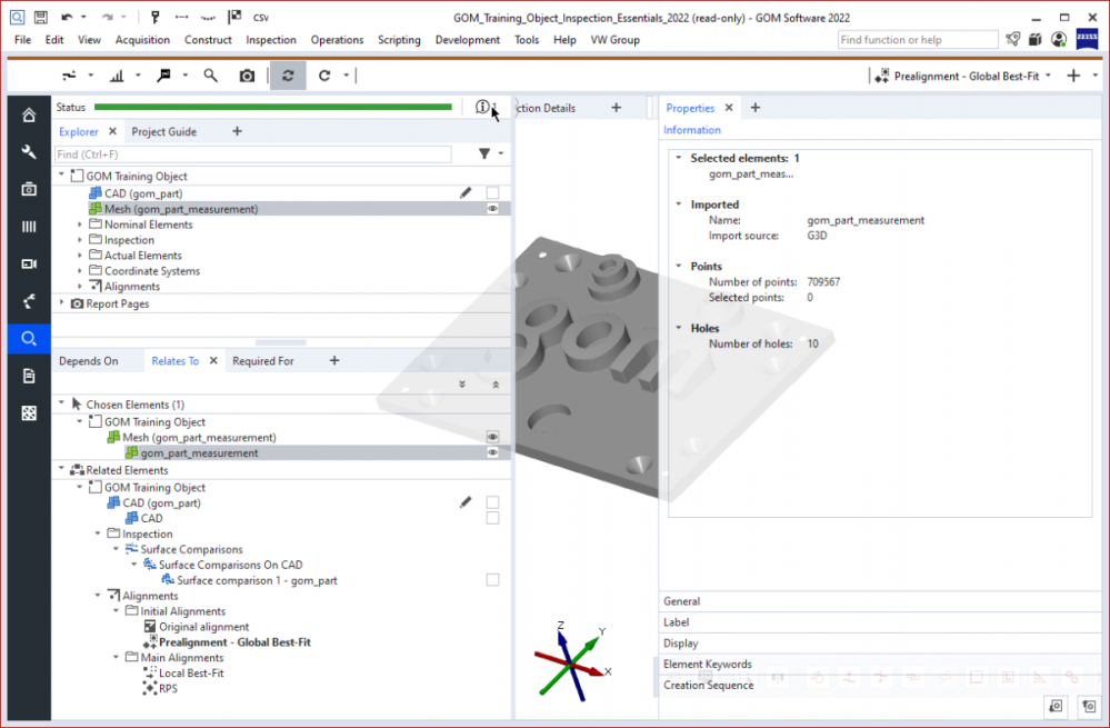

[Ry...] Posted November 6, 2023 Author Share Posted November 6, 2023 I suppose a different question then, is there a way to check if the mesh is manifold and watertight? Link to comment https://qualityforum.zeiss.com/topic/3389-deleting-small-objects/#findComment-9379 Share on other sites More sharing options...

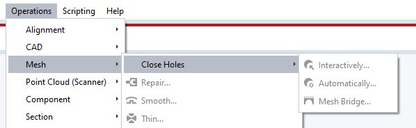

[Au...] Posted November 6, 2023 Share Posted November 6, 2023 Would "Close Holes" be the correct method for this? I am not sure if this is correct but seems to make sense to me. Link to comment https://qualityforum.zeiss.com/topic/3389-deleting-small-objects/#findComment-9383 Share on other sites More sharing options...
[Na...] Posted November 6, 2023 Share Posted November 6, 2023 Hi, in the properties of the mesh you can see the number of holes: There is a function "eliminate mesh errors", which displays errors with the mesh (and might fix them) but it is usually not necessary: ZEISS Quality Tech Guide Nanno Link to comment https://qualityforum.zeiss.com/topic/3389-deleting-small-objects/#findComment-9387 Share on other sites More sharing options...
