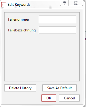

[ev...] Posted August 3, 2021 Share Posted August 3, 2021 Hello, at the company where I work we started to move from Piweb to eMMA to do statistical analyses but the mess plan from our costumer can not be imported directly in the software eMMa (BMW ipp as .csv), this software can also import Qdas files but when I try to export from gom with this format the keywords can not be changed, there are just two options: It does not matter if there are more keywords in the Report work space. Is it possible to add more keywords in this format? Link to comment https://qualityforum.zeiss.com/topic/339-export-keywords-in-qdas-format/ Share on other sites More sharing options...

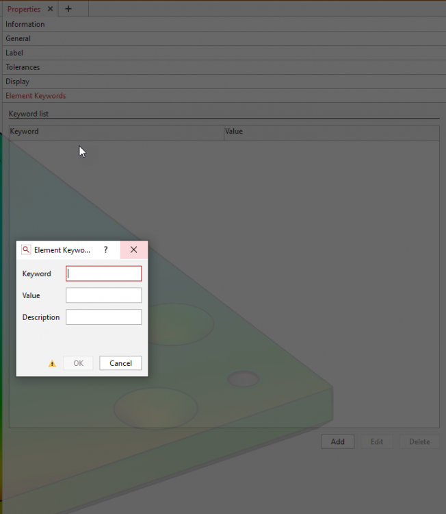

[Na...] Posted August 4, 2021 Share Posted August 4, 2021 Hello, the dialog you posted is for Keywords used to display them on a report page in our software, for example. Keywords for QDAS are defined in the Properties tab on the right: Regards, Nanno Link to comment https://qualityforum.zeiss.com/topic/339-export-keywords-in-qdas-format/#findComment-974 Share on other sites More sharing options...
