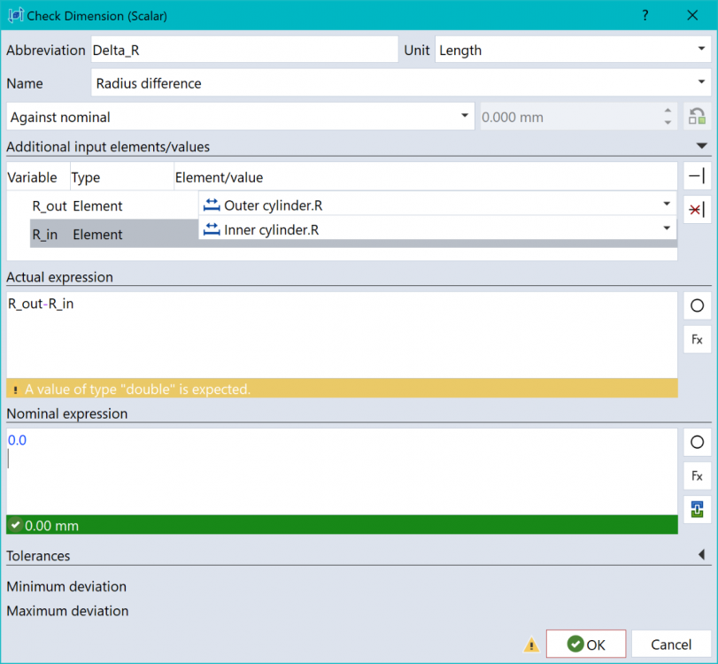

[Er...] Posted November 13, 2023 Share Posted November 13, 2023 Can 'Check User-Defined' be used to calculate the radius difference between two cylinders that are nominally coaxial? I tried the following, but it didn't work: Thank you and best regards, Erik de Lange Link to comment https://qualityforum.zeiss.com/topic/3405-calculating-the-radius-difference-of-two-nominally-coaxial-cylinders/ Share on other sites More sharing options...

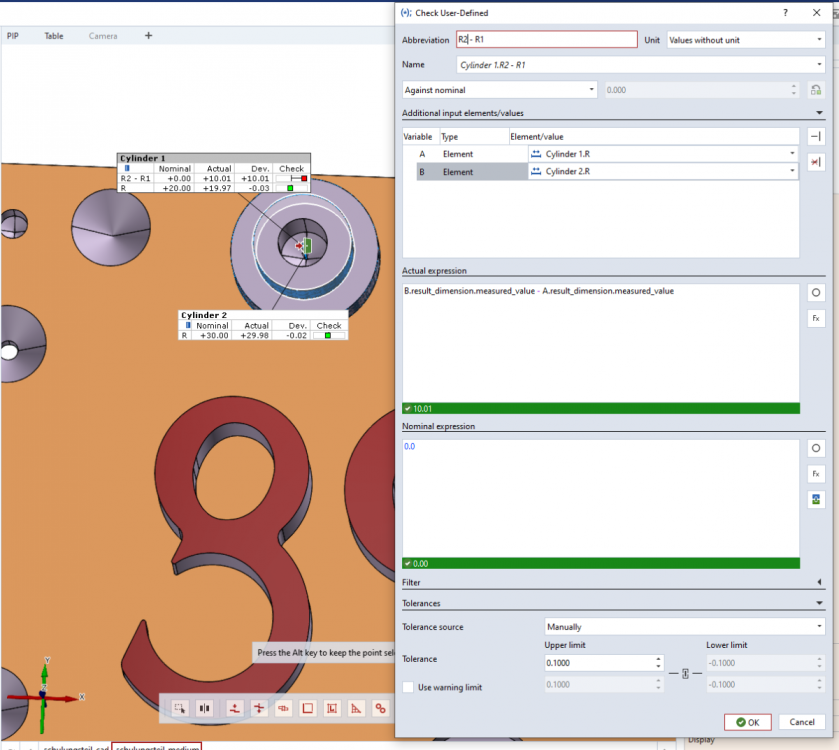

[Mi...] Posted November 13, 2023 Share Posted November 13, 2023 You need to access the relevant tokens of the two radius checks that you reference in your user defined check. The attached screenshot should clarify this. Link to comment https://qualityforum.zeiss.com/topic/3405-calculating-the-radius-difference-of-two-nominally-coaxial-cylinders/#findComment-9467 Share on other sites More sharing options...
[Er...] Posted November 13, 2023 Author Share Posted November 13, 2023 It works!👍 Thank you, Michael!!😀 Link to comment https://qualityforum.zeiss.com/topic/3405-calculating-the-radius-difference-of-two-nominally-coaxial-cylinders/#findComment-9473 Share on other sites More sharing options...
