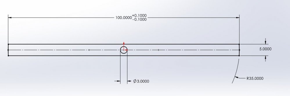

[Ti...] Posted November 23, 2023 Author Share Posted November 23, 2023 (edited) Please sign in to view this username. Below is an example of a simple case where the 100mm +/- 0.1mm width. The ends are radiused so the length is to and from the extreme tangent points. Using a position tolerance on this length is not a perfect way to do things, but as I have said plenty of times on here, customer prints are not always to the standards. Furthermore, you could argue that a positional tolerance on this length 'could' be the most efficient way to measure a desired outcome that both 'extreme tangent points' are a distance away from the center hole to a pretty tight tolerance. You can't reliably use each end radius as a separate position b/c those cylinders you would create may not be stable due to the small degree of arc. Surface profile would be the go to solution, BUT surface profile factors in the lows and the high points AND surface profile does not allow Bonus. So how do you control the below example...while position is not ideal per the standard, you can easily make a hard gauge for this to control position, you can easily do this on a CMM, and on a vision system. i personally don't care that this isn't a 'feature of size' per the standards definition, I know that is is a size that can fluctuate and I can make an accurate measurement of this feature of length. In GOM you could collapse a disc caliper using the longwise surface planes for direction, and use a disc intersection point to get this points in space, then make a mid point. I then use the user defined checks to calculate my bonus, another user defined check to find my diametrical mid point deviation, then a final user defined check to use the formula stated earlier to check that my bonus + stated tolerance is larger than my diametrical deviation. A real nice solution that you can use in pcdmis cmm is make a circle out of your mid point and one of the outer extreme points. This circle allows you to get a feature of size check and position check. In fact this strategy actually works inside GOM except one big problem....it allows you to create a linear size of the circle and then allows you to do a MMC position check....BUT the problem is GOM is not passing the MMC data to the position check. So it appears to work, but it is not passing along the bonus to the output. Edited November 23, 2023 Link to comment https://qualityforum.zeiss.com/topic/3423-feature-request-user-defined-check-add-variables-to-tolerance-fields/#findComment-9623 Share on other sites More sharing options...

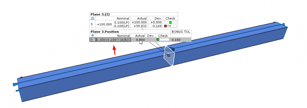

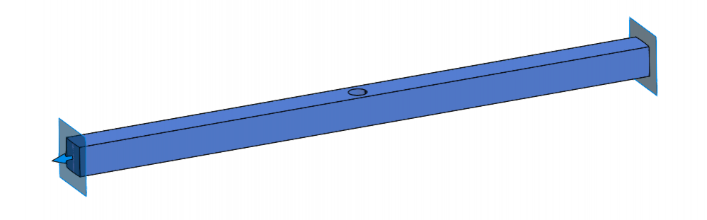

[Ji...] Posted November 27, 2023 Share Posted November 27, 2023 One option that may work for you is to use a CAD file that has square ends. Then you can create a size dimension that can be used in the position callout of the centerplane. The algorithm that you choose for the size dimension calculation can be modified to your liking. This size dimension will then be associated to the positional callout and bonus tolerance will then be applied. I created a model based on your sketch and tried it - seems to work: Link to comment https://qualityforum.zeiss.com/topic/3423-feature-request-user-defined-check-add-variables-to-tolerance-fields/#findComment-9633 Share on other sites More sharing options...
[Ti...] Posted November 28, 2023 Author Share Posted November 28, 2023 Please sign in to view this username. ' Jim...thanks for sharing. That is an interesting approach, I'll have to give that a shot. quite intersting, thank you. Link to comment https://qualityforum.zeiss.com/topic/3423-feature-request-user-defined-check-add-variables-to-tolerance-fields/#findComment-9637 Share on other sites More sharing options...
[Ji...] Posted November 28, 2023 Share Posted November 28, 2023 You are welcome. As a follow-up, I believe it can be argued that this example you provided is indeed a feature of size by definition. Perhaps you should urge Zeiss to consider including features such as this for creating GD&T size dimensions. Link to comment https://qualityforum.zeiss.com/topic/3423-feature-request-user-defined-check-add-variables-to-tolerance-fields/#findComment-9643 Share on other sites More sharing options...
[Ti...] Posted November 29, 2023 Author Share Posted November 29, 2023 Please sign in to view this username. I agree with you capturing a length like this should be able to be done with GDT in the software. We need the ability to push the limits here and there and not be so confined to a technical nature. That said, I'll argue from a purist standpoint this is not a feature of size because it lacks what I call 'confinement'. The asme standard states in the 2009 standard that a regular feature of size(fos) is: 'one cylindrical or spherical surface, a cicrular element, and a set of two opposed parallel elements or opposed parallel surfaces, each of which are directly toleranced' Then it states there are irregular fos which are: directly toleranced features that "may contain or be contained by an actual mating envelope" This feature I provided is not regular, and then to be considered irregular would need to be able to be 'contained' ie. locked down by a hard gauge. So my purist opinion is it is not a fos. But a quick hard gauge would be to make a pin for the center hole(primary datum) so you can spin the part around with the flick of a finger. Then you collapse a plane perpedicular to the longwise body surface(secondary datum) until it cannot rotate around anymore. Then rotate the part to the other side and push a feeler gauge until you get a solid contact. Now you know your position ;) Link to comment https://qualityforum.zeiss.com/topic/3423-feature-request-user-defined-check-add-variables-to-tolerance-fields/#findComment-9653 Share on other sites More sharing options...

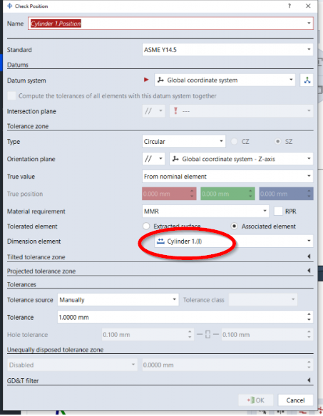

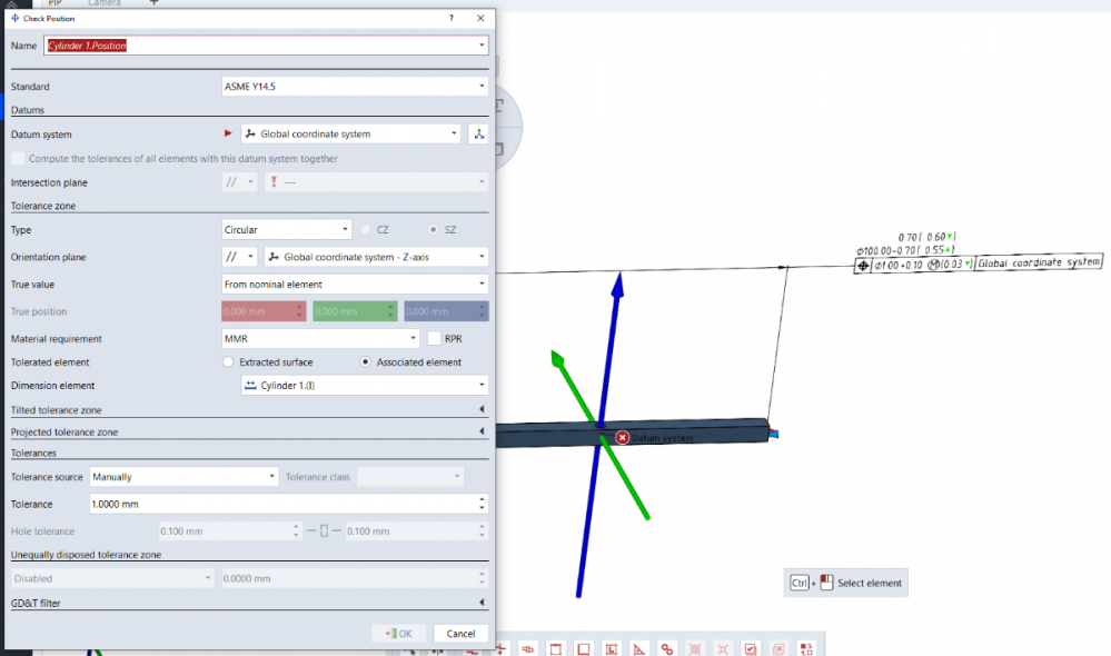

[Di...] Posted November 29, 2023 Share Posted November 29, 2023 (edited) Hi, regarding the provided CAD element I created my own one using the data from your sketch. And I do not see the problem. What I'm doing different compared to your approach? Regarding more complex features (ASME freeform shaped irregular features): This is indeed not yet supported. So if you like to have this please send a software wish to our support department. Thank you very much for sharing your wishes with us. Best regards Dinko Edited November 29, 2023 Link to comment https://qualityforum.zeiss.com/topic/3423-feature-request-user-defined-check-add-variables-to-tolerance-fields/#findComment-9663 Share on other sites More sharing options...

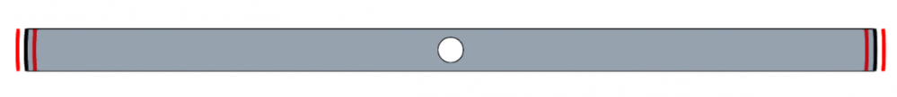

[Ji...] Posted November 29, 2023 Share Posted November 29, 2023 Dinko, I see the "tolerated element" you used for the size is a cylinder: If you look at his sketch, there is no such cylinder that exists. There are two separate arcs (one on each end) that don't share a common center point. The feature of size that is referenced is the outermost distance of these arcs. Link to comment https://qualityforum.zeiss.com/topic/3423-feature-request-user-defined-check-add-variables-to-tolerance-fields/#findComment-9667 Share on other sites More sharing options...
[Ti...] Posted December 1, 2023 Author Share Posted December 1, 2023 (edited) Please sign in to view this quote. You cannot 'contain the radii at the end of this long part with two plane. You can collapse two planes and 'touch' each end but the slightest flick of a finger and the part would dislodge and spin freely. Containment means you have immobilized the features with the UAME, unrelated actual mating envelope. Two planes collapsing upon these radii end points is not a mating envelope. It is real simple to add this to the software....We can already create two opposing points in the software and then a midpoint. Then we can create a normal circle using the midpoint and one of the outer points to parametrically define the cirlce.....Now there is a feature of size built 'generically' same as we do in PCDMIS. You can even go into the linear dimension and generate a GDT size for this generic circle. You can also then apply this MMR feature to a bonus position callout. BUT....as I have said before....all this works EXCEPT....the bonus does not get pushed over into the positional check. Everything works, except the bonus doesn't carry over. if you all can add the carryover into the position check, i can create all the position checks I want that are not purist feature of sizes. Edited December 1, 2023 Link to comment https://qualityforum.zeiss.com/topic/3423-feature-request-user-defined-check-add-variables-to-tolerance-fields/#findComment-9683 Share on other sites More sharing options...
[Ji...] Posted December 4, 2023 Share Posted December 4, 2023 Hello Tim - This is certainly an interesting conversation. Based on your last comment, I see where we differ in our viewpoints is in the definition of the word "contained". I believe you have interpreted it to mean "restrained" or "constrained" as are typically used when a part is to be fully immobilized. In this case, the word "contained" means that the feature is question must be "enclosed" or "bound" by two parallel planes. Of course, the vector direction of measurement has to be defined and would be the same direction as the two bounding parallel planes. So, from my experience, the example you have provided is indeed considered an "irregular" feature of size. Also, as Dinko Sabo has commented above, "Regarding more complex features (ASME freeform shaped irregular features): This is indeed not yet supported." From this standpoint, I believe the ball is in Zeiss' court add functionality to the software to support irregular features of size. Link to comment https://qualityforum.zeiss.com/topic/3423-feature-request-user-defined-check-add-variables-to-tolerance-fields/#findComment-9695 Share on other sites More sharing options...
[Ti...] Posted December 10, 2023 Author Share Posted December 10, 2023 (edited) Please sign in to view this username. To have a feature of size regardless if it is irregular, it must have a 'mating envelop'. You quoted the standard above referencing the abbreviation 'AME'...actual mating envelope. A feature to have a size must mate up with another feature. Two collapsing planes can only touch two extreme points in this situation...that does not mate, it only touches. Try that mating strategy in Solidworks, or Siemens NX. If it did everything under the sun would be a feature of size. So two planes collapsing upon a part can only find two identifiable extreme points is now considered a 'mating envelop'? Those parts are now mated together by those two points? Edited December 10, 2023 Link to comment https://qualityforum.zeiss.com/topic/3423-feature-request-user-defined-check-add-variables-to-tolerance-fields/#findComment-9745 Share on other sites More sharing options...
[Ji...] Posted December 11, 2023 Share Posted December 11, 2023 The mating envelope would be the extreme boundaries of the surface in consideration (in this case the small radii on each end). The size dimension would be the extreme distance in the direction of two parallel planes. Link to comment https://qualityforum.zeiss.com/topic/3423-feature-request-user-defined-check-add-variables-to-tolerance-fields/#findComment-9748 Share on other sites More sharing options...
