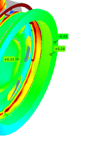

[Ar...] Posted November 17, 2023 Share Posted November 17, 2023 It used to be very nice view in CAD comparison. Only thing i did was tried out the Photorealistic View and after that all new programs show this eye burning comparison view with unable to tell where the boundaries are. How do I get back to old? Link to comment https://qualityforum.zeiss.com/topic/3435-cad-comparison-colors-changed-by-itself-how-to-get-it-back-as-it-was/ Share on other sites More sharing options...

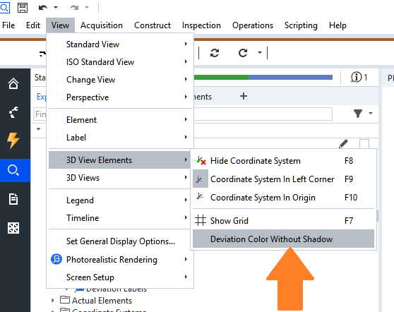

[Ha...] Posted November 17, 2023 Share Posted November 17, 2023 Dear Ari, Choose under View -> 3D View Elements -> Deviation Colors Without Shadow. Switch this off BR Harry Link to comment https://qualityforum.zeiss.com/topic/3435-cad-comparison-colors-changed-by-itself-how-to-get-it-back-as-it-was/#findComment-9555 Share on other sites More sharing options...
[Ar...] Posted November 17, 2023 Author Share Posted November 17, 2023 Hi Harry, Thank you very much! Exactly the right setting. Have a nice weekend! Link to comment https://qualityforum.zeiss.com/topic/3435-cad-comparison-colors-changed-by-itself-how-to-get-it-back-as-it-was/#findComment-9557 Share on other sites More sharing options...
