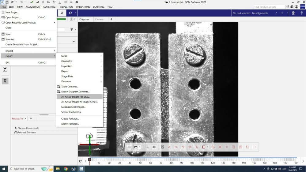

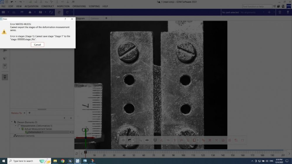

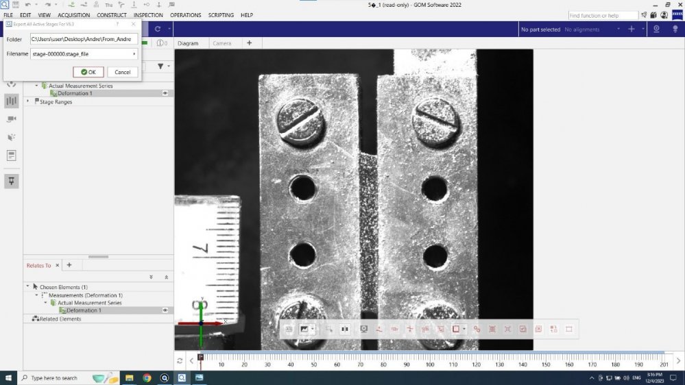

[La...] Posted December 5, 2023 Share Posted December 5, 2023 The deformation series is captured by ARAMIS 2D 12M with reduce resolution of 5M but I tried to export All Active Stages for V 6.3 an error is occurred. The images are below. Please help! Link to comment https://qualityforum.zeiss.com/topic/3473-aramis-2d-exoprt-all-active-stages/ Share on other sites More sharing options...
[Th...] Posted December 6, 2023 Share Posted December 6, 2023 Hi Lalitesh, as the v6.3 (-format incl. calibration) does not support the given image size (partial image) directly, the export does not work. What do you need the images/ data for?! If you want to export only images (+ calibration-file) you can do this via Export -> All Active Stages As Image Series or simply Measurement Images. Hope this helps. Best regards, Thorsten Link to comment https://qualityforum.zeiss.com/topic/3473-aramis-2d-exoprt-all-active-stages/#findComment-9711 Share on other sites More sharing options...
