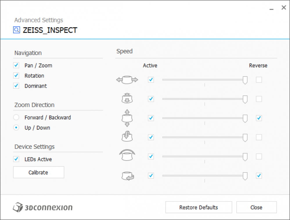

[Pa...] Posted May 29, 2024 Share Posted May 29, 2024 I have a related issue in that I want to switch the zoom direction from forwards/backwards to up/down. When I check this option, nothing changes. Zeiss Inspect is supposed to be supported in 3Dconnexion products. Link to comment https://qualityforum.zeiss.com/topic/3514-3dconnexion-spacemouse/#findComment-11618 Share on other sites More sharing options...
[Br...] Posted June 5, 2024 Author Share Posted June 5, 2024 Please sign in to view this quote. I can corroborate this issue, the reverse does not work for me either. I am stoked that the Spacemouse is actually usable with Zeiss Inspect. Link to comment https://qualityforum.zeiss.com/topic/3514-3dconnexion-spacemouse/#findComment-11651 Share on other sites More sharing options...

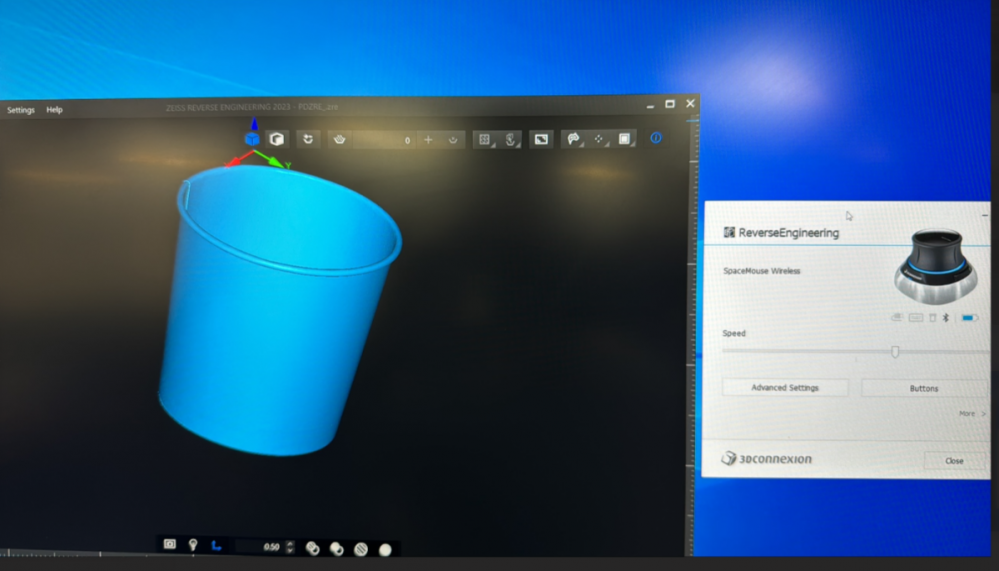

[Br...] Posted September 4, 2024 Author Share Posted September 4, 2024 (edited) Bought a new 3Dconnexion Space mouse, now I cannot get this to work at all in ZRE. It works fine in SolidWorks, and in the 3DConnexion viewer, and it seems to recognize the ZRE software (as seen in the pic). Any ideas on this from the group? Edited September 4, 2024 Updated pic Link to comment https://qualityforum.zeiss.com/topic/3514-3dconnexion-spacemouse/#findComment-12401 Share on other sites More sharing options...
[Ma...] Posted May 15 Share Posted May 15 Hi Everyone, My name is Maciej and I work at 3Dconnexion. Earlier this year, I noticed this issue on the ZEISS forum, and we were able to fix it. After installing the latest 3Dconnexion driver, you should be able to reverse the movement and rotation axes as well as adjust the movement speed. We have implemented these changes for ZEISS INSPECT and ZEISS CALYPSO. I hope your experience with our devices will now be even better Best regards Maciej Fornal 2 1 Link to comment https://qualityforum.zeiss.com/topic/3514-3dconnexion-spacemouse/#findComment-150674 Share on other sites More sharing options...
