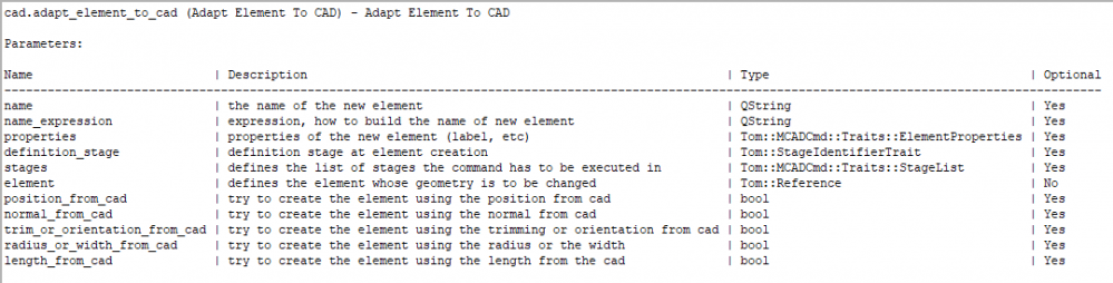

[a1...] Posted January 5, 2024 Share Posted January 5, 2024 (edited) attached are all the gom script functions as of version 2018 (versions higher than that use an external python version instead of goms custom gom_python) Figure someone else might find these useful since there are a lot of script commands that arent easy to capture via "record" or not possible to record in the first place you can get the docstrings for each command by adding "__doc__" after the command and printing it, for example, viewing the doctrings of gom.script.cad.adapt_element_to_cad would be- # -*- coding: utf-8 -*- import gom print(gom.script.cad.adapt_element_to_cad.__doc__) gom.script.cad.adapt_element_to_cad would result in Im not sure what the "Tom::" types are, but maybe a German could explain that, Im assuming its some C++ type or something like that gom.interactive.txt gom.script.txt Edited January 5, 2024 Link to comment https://qualityforum.zeiss.com/topic/3534-gom-script-functions-as-of-version-2018/ Share on other sites More sharing options...
