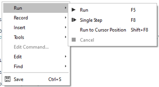

[Ju...] Posted January 16, 2024 Share Posted January 16, 2024 (edited) Hello everybody, we recently updated from GOM Inspect Pro 2018 to GOM Suite and GOM Inspect Pro 2022. While working with scripts, I always started them using "Single Step" when debugging. In the new software version, I can only start normally with the "Run" button (see pictures below). Do you have the same problem? Can I fix it somehow? Will the problem be solved with future updates? Thanks! 2018 Version: 2022 Version: Edited January 16, 2024 Link to comment https://qualityforum.zeiss.com/topic/3569-missing-single-step-option-for-running-a-script-in-gom-inspect-pro-2022/ Share on other sites More sharing options...
[Na...] Posted January 17, 2024 Share Posted January 17, 2024 Hello Julian, it is now possible to Visual Studio Code as an add-on editor, where single steps are available: Using Visual Studio Code as an add-on editor — Add-On Documentation (zeissiqs.github.io) Nanno Link to comment https://qualityforum.zeiss.com/topic/3569-missing-single-step-option-for-running-a-script-in-gom-inspect-pro-2022/#findComment-10107 Share on other sites More sharing options...
[An...] Posted January 20, 2024 Share Posted January 20, 2024 Functions already contained in the integrated editor (step-by-step execution, running color bar for display of currently executed command) are taken from there to indicate that these are all contained in the external programming environment, which the programmer - especially the "occasional programmer" - must first familiarize himself with in a more or less time-consuming manner. If you start a script in the external programming environment, you can of course only see the execution of the script, i.e. the result of the script run, in ZEISS Inspect - a second monitor for "distributing" the two applications is therefore "mandatory". To define a dialog window, however, please switch back to the editor integrated in ZEISS Inspect, as you cannot define these dialog windows in the external programming environment, at least that is my current state of knowledge. My conclusion: a little bit here, a little bit there. All in all, a great thing. Link to comment https://qualityforum.zeiss.com/topic/3569-missing-single-step-option-for-running-a-script-in-gom-inspect-pro-2022/#findComment-10125 Share on other sites More sharing options...
[Ju...] Posted January 25, 2024 Author Share Posted January 25, 2024 Hello Nanno, Hello Andreas, thanks for the help! I am indeed an "occasional programmer". But I think with the guide and and a few hours of effort I can get used to Visual Studio and get back to debugging. Link to comment https://qualityforum.zeiss.com/topic/3569-missing-single-step-option-for-running-a-script-in-gom-inspect-pro-2022/#findComment-10191 Share on other sites More sharing options...
