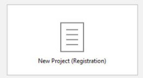

[Xi...] Posted January 25, 2024 Share Posted January 25, 2024 (edited) It is showed "Registration" as following, but my Zeiss-ID has been logged in. Why? Edited January 25, 2024 Link to comment https://qualityforum.zeiss.com/topic/3595-why-new-project-function-of-gom-inspect-2022-cannot-be-use/ Share on other sites More sharing options...
[Xi...] Posted January 25, 2024 Author Share Posted January 25, 2024 Zeiss-ID must be a *@gmail.com ? Link to comment https://qualityforum.zeiss.com/topic/3595-why-new-project-function-of-gom-inspect-2022-cannot-be-use/#findComment-10185 Share on other sites More sharing options...

[Xi...] Posted January 26, 2024 Author Share Posted January 26, 2024 I have already solved this problem. The reason is that the Codemeter's service is not started. The following file need to change name then the Codemeter's service could be started. C:\WINDOWS\SYSTEM32\DRIVERS\multikey.sys Then follow the prompts of the ZEISS software to get a file on the web page, import it into Codemeter, if succeeded, then could run the Pro-version in 14 days. I don't know whether I can run the "new project" after 14 days.....😵 Link to comment https://qualityforum.zeiss.com/topic/3595-why-new-project-function-of-gom-inspect-2022-cannot-be-use/#findComment-10213 Share on other sites More sharing options...
[Na...] Posted January 26, 2024 Share Posted January 26, 2024 Please sign in to view this quote. Hi, you will be able to create new projects with the free version. Link to comment https://qualityforum.zeiss.com/topic/3595-why-new-project-function-of-gom-inspect-2022-cannot-be-use/#findComment-10221 Share on other sites More sharing options...
[Xi...] Posted January 27, 2024 Author Share Posted January 27, 2024 Please sign in to view this quote. That's great !!!😄 Link to comment https://qualityforum.zeiss.com/topic/3595-why-new-project-function-of-gom-inspect-2022-cannot-be-use/#findComment-10231 Share on other sites More sharing options...

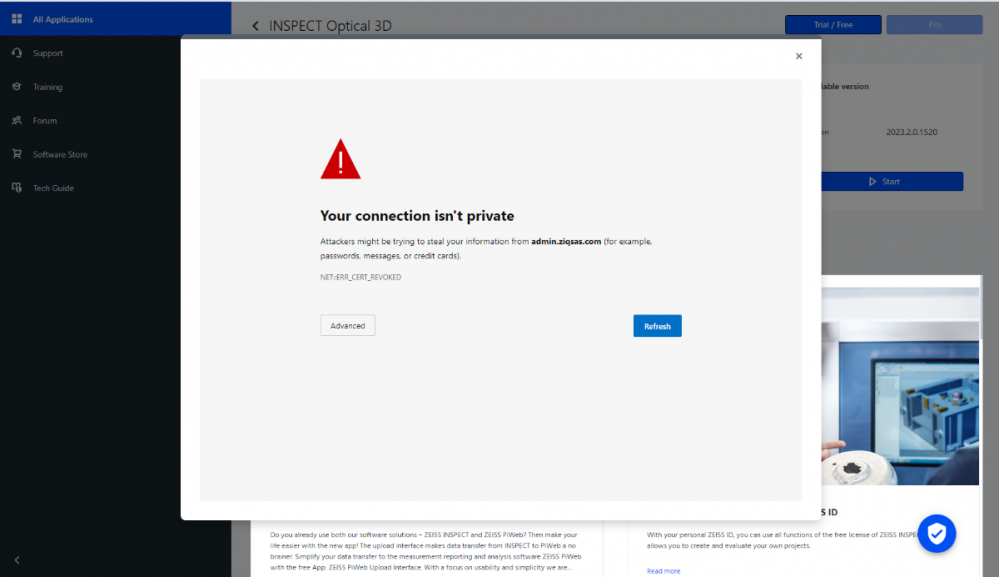

[Fe...] Posted January 31, 2024 Share Posted January 31, 2024 I'm having this error when trying to activate the trial. Does someone else had the same issue? Link to comment https://qualityforum.zeiss.com/topic/3595-why-new-project-function-of-gom-inspect-2022-cannot-be-use/#findComment-10282 Share on other sites More sharing options...
[St...] Posted February 1, 2024 Share Posted February 1, 2024 Please sign in to view this quote. This was an issue with the SSL certificate. It is already fixed and you should be able to activate your trial license Link to comment https://qualityforum.zeiss.com/topic/3595-why-new-project-function-of-gom-inspect-2022-cannot-be-use/#findComment-10296 Share on other sites More sharing options...

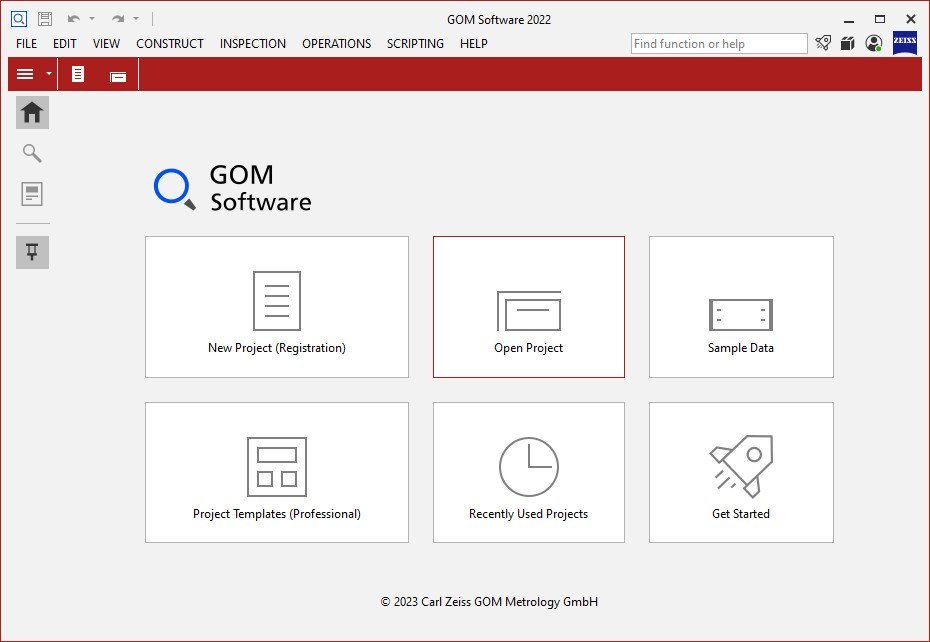

[Xi...] Posted February 22, 2024 Author Share Posted February 22, 2024 Please sign in to view this quote. Unfortunately, the software can no longer run "New Project", the PRO license expires on February 10th. 😬 Link to comment https://qualityforum.zeiss.com/topic/3595-why-new-project-function-of-gom-inspect-2022-cannot-be-use/#findComment-10528 Share on other sites More sharing options...
[Na...] Posted February 23, 2024 Share Posted February 23, 2024 Hi, you are still using the Software version 2022. The free licence runs out with the end of every year (2022 with end of 2023 for example). You have to use the 2023 version and request a free licence there. Nanno Link to comment https://qualityforum.zeiss.com/topic/3595-why-new-project-function-of-gom-inspect-2022-cannot-be-use/#findComment-10550 Share on other sites More sharing options...
