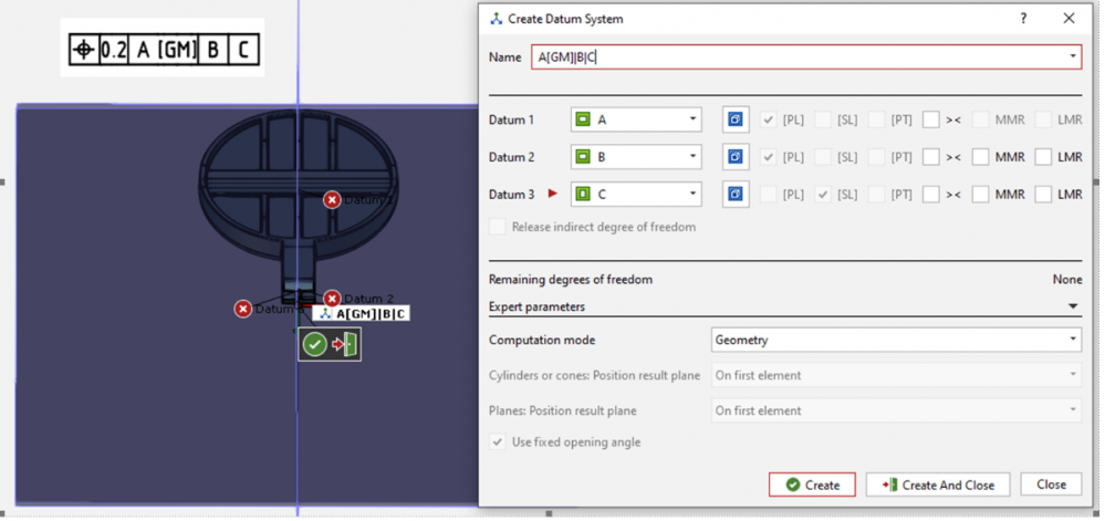

[Ma...] Posted January 30, 2024 Share Posted January 30, 2024 Given is a datum system A | B | C|, where datum A shall be evaluated using the gaussian association criteria, but chebyshev for datum B an C. The computation mode "geometry" can only be selected for the complete datum system and not individually for datum 1, 2 and 3 The following questions arise: Is it possible to select "geometry" computation mode just certain datums? Could the correct evaluation of the results achieved by using a fitting elements Datum A: Gaussian best-fit Datum B and C: Chebyshev outside material Thanks for your answers. Best regards, Martin Link to comment https://qualityforum.zeiss.com/topic/3613-gaussian-association-criteria-only-for-some-datums/ Share on other sites More sharing options...
[Lu...] Posted January 30, 2024 Share Posted January 30, 2024 Hi Martin, as you wrote already, it is possible to set the different Computation Modes via the fitting elements. To do this, select "Geometry" as the mode in the datum system and set the separate fitting elements to Gaussian best-fit or Chebyshev Outside Material. Best regards, Lukas Link to comment https://qualityforum.zeiss.com/topic/3613-gaussian-association-criteria-only-for-some-datums/#findComment-10253 Share on other sites More sharing options...
