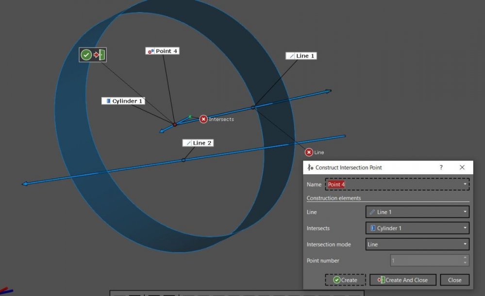

[Ch...] Posted August 16, 2021 Share Posted August 16, 2021 See attached screenshot. How can I measure from Plane 35 to outer edge of Cylinder 1, as represented by the red line? Any help is appreciated. Chris Link to comment https://qualityforum.zeiss.com/topic/364-how-to-measure-to-edge-of-cylindercircle/ Share on other sites More sharing options...
[Ch...] Posted August 17, 2021 Share Posted August 17, 2021 1. Construct Perpendicular Line (Cylinder + Plan) 2. No Measuring Principle 3. Construct Intersection Point (Line-Cylinder-Surface-Point 1 or 2) 4. Referenced Construction 5. Construct Distance - Projected Point Distance (Point + Plane) 6. Referenced Construction 7. Check Distance Link to comment https://qualityforum.zeiss.com/topic/364-how-to-measure-to-edge-of-cylindercircle/#findComment-1061 Share on other sites More sharing options...
[Ti...] Posted January 24, 2023 Share Posted January 24, 2023 (edited) I used to be able to do this in GOM 2021 very easily. I can't this to work in 2022. I'm looking to get the intersection point of the line and cylinder surface not the cylinder axis. It used to pop up and allow you to pick surface point 1 or 2 if it passed thru 2 surface points. Edited January 24, 2023 Link to comment https://qualityforum.zeiss.com/topic/364-how-to-measure-to-edge-of-cylindercircle/#findComment-6662 Share on other sites More sharing options...
[Ti...] Posted January 25, 2023 Share Posted January 25, 2023 I found the solution...I completely forgot about changing the intersection mode from line to surface. Link to comment https://qualityforum.zeiss.com/topic/364-how-to-measure-to-edge-of-cylindercircle/#findComment-6664 Share on other sites More sharing options...
