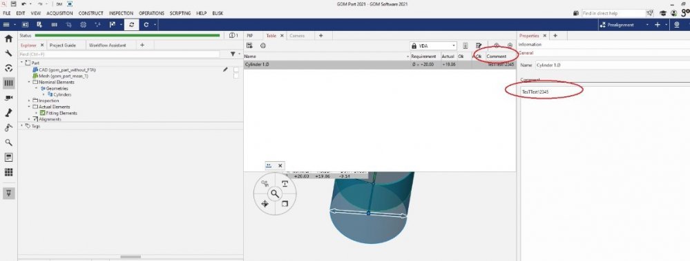

[Sh...] Posted August 18, 2021 Share Posted August 18, 2021 Hello, Sorry if this has been answered before but is there a way to report visual checks? I know it's not a measurement but it would be nice to have everything in one report. For example, verifying a part number is molded into the plastic, or verifying the weld points are at the correct location. Is there a way to add a single line on a report page and just type in some simple verbiage? I tried adding a row but it adds a row under each item. Link to comment https://qualityforum.zeiss.com/topic/366-reporting-visual-checks/ Share on other sites More sharing options...
[Je...] Posted August 19, 2021 Share Posted August 19, 2021 Hello Mr. Warren, If I got the problem right: You can add test in a table in the comment section (This can be placed as reportpage for documentation). If not please add a screenshot to describe your needs. Best regards, Jens Heidler Link to comment https://qualityforum.zeiss.com/topic/366-reporting-visual-checks/#findComment-1071 Share on other sites More sharing options...
