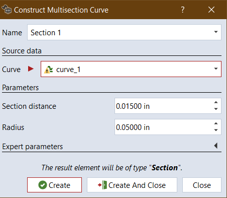

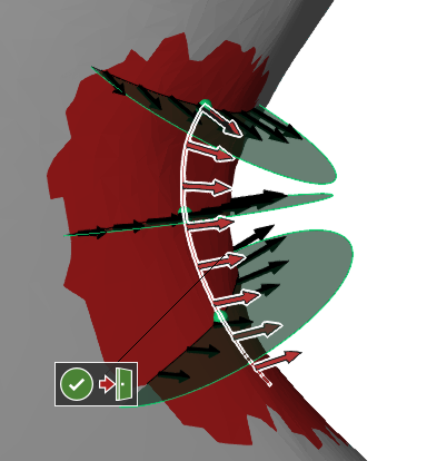

[Ku...] Posted February 25, 2024 Share Posted February 25, 2024 Hi, I would like to create multisection along a curve. The parameter to control section location is the distance from the first point of the curve. However, I would like to distribute the 3 sections along the entire curve length and this curve length can vary depending on actual mesh geometry. I know that I can do it with scripting by getting the curve length from the element information, but I prefer to use template only. Is there a way to do this in a GOM template without scripting? Thank you very much! Kun Link to comment https://qualityforum.zeiss.com/topic/3700-how-to-create-3-equally-spaced-multi-section-along-entire-curve-length/ Share on other sites More sharing options...
[Na...] Posted March 8, 2024 Share Posted March 8, 2024 Hello, there might be a possibility using a user defined inspection principle. How should they be distributed? On both end points and in the middle? Nanno Link to comment https://qualityforum.zeiss.com/topic/3700-how-to-create-3-equally-spaced-multi-section-along-entire-curve-length/#findComment-10774 Share on other sites More sharing options...
