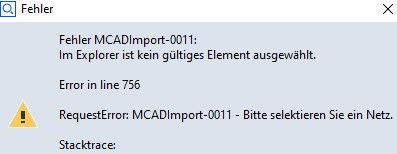

[Ja...] Posted June 21, 2024 Share Posted June 21, 2024 Hi, I am working on a script that should do nearly the same: Exporting the stl files. But I have a problem when the part name isn't 'part'. Then the call elements=gom.ElementSelection ({'category': ['key', 'elements', 'part', gom.app.project.parts['Part'], 'explorer_category', 'actual_part']}), gives back an error. I think it is about this entry: gom.app.project.parts['Part'] Is there a way to tell the command that all parts shall to be used? Link to comment https://qualityforum.zeiss.com/topic/3727-exporting-stl-from-ginspect/#findComment-11825 Share on other sites More sharing options...
[Ja...] Posted June 21, 2024 Share Posted June 21, 2024 If you only have one part can replace 'Part' with 0 . I.e. Returns the first value of the list of part entries . If you have multiple parts you would then need a loop to deal with exporting all of them. Hope that helps James Link to comment https://qualityforum.zeiss.com/topic/3727-exporting-stl-from-ginspect/#findComment-11828 Share on other sites More sharing options...
