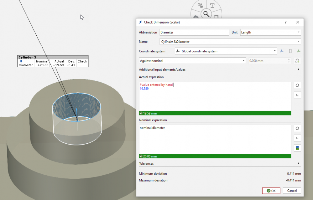

[Le...] Posted August 23, 2021 Share Posted August 23, 2021 Hello, I'm looking for a way to input manually taken measurements. For example if I'm measuring a part and there is a specific dimension I can't get scan info on, but I can measure it with a pin gage. Is there a way to put an item in the table to manual input a new dimension, or manually input a measurement on an existing dimension? Thank you for the help. Link to comment https://qualityforum.zeiss.com/topic/375-manual-measurement-entry/ Share on other sites More sharing options...
[Na...] Posted August 23, 2021 Share Posted August 23, 2021 Hello Lee, you can create the nominal element as usual on the CAD and use I-Inspect to perform a user defined check on it. In this dialog you can enter a value by hand: Regards, Nanno Link to comment https://qualityforum.zeiss.com/topic/375-manual-measurement-entry/#findComment-1092 Share on other sites More sharing options...
[Le...] Posted August 23, 2021 Author Share Posted August 23, 2021 Please sign in to view this quote. Got it. That worked, thanks for the help. Link to comment https://qualityforum.zeiss.com/topic/375-manual-measurement-entry/#findComment-1094 Share on other sites More sharing options...
