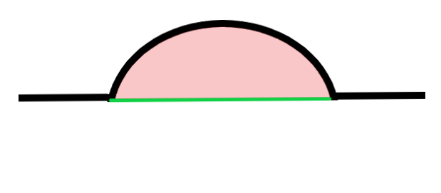

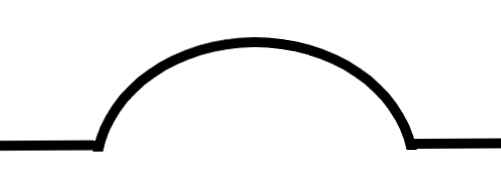

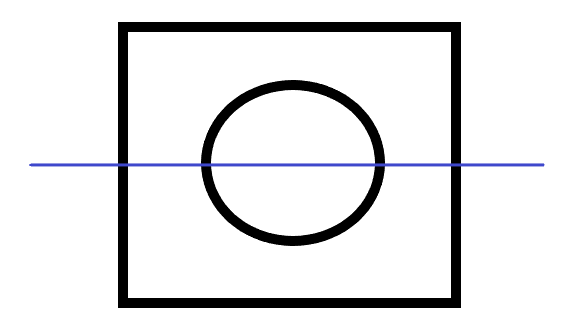

[To...] Posted March 11, 2024 Share Posted March 11, 2024 Hello, I have a STL of a dome shape and want to measure the volume of it relative to a plane fitted to the top surface. I can't do this by just fitting geometry elements to the surface, such as fitting a sphere and using that to calculate it, I have to measure it to the actual mesh itself. Below are some diagrams: Top view of sample, dome in the middle, blue line showing cross section for second diagram: Cross section view: Cross section view with fitted plane show in green and desired volume in red: Any help would be greatly appreciated. Let me know if I can clarify anything. Link to comment https://qualityforum.zeiss.com/topic/3756-how-do-i-measure-the-volume-encapsulated-by-a-plane-and-an-actual-mesh/ Share on other sites More sharing options...
