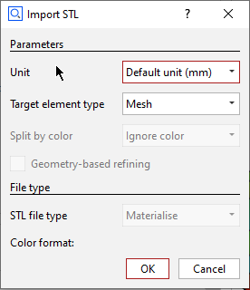

[Ga...] Posted March 12, 2024 Share Posted March 12, 2024 (edited) CAD is in inches and mesh part in mm. how to update the units for mesh? Edited March 12, 2024 Link to comment Share on other sites More sharing options...
[Na...] Posted March 12, 2024 Share Posted March 12, 2024 Hello, you may export the mesh from your project as STL and import it. Then this dialog will pop up: Link to comment Share on other sites More sharing options...
[Be...] Posted March 12, 2024 Share Posted March 12, 2024 Keep in mind: All internal values in ZEISS INSPECT are stored in millimeters. If your CAD geometry is represented in inch you should ask for a conversion of the CAD file. Otherwise you could get in trouble if you export the data or create some visualizations. Changing the unit in ZEISS INSPECT only changes the visualizations but not the internal representation, e.g. scripted access to these values all still reported in millimeters. Link to comment Share on other sites More sharing options...
