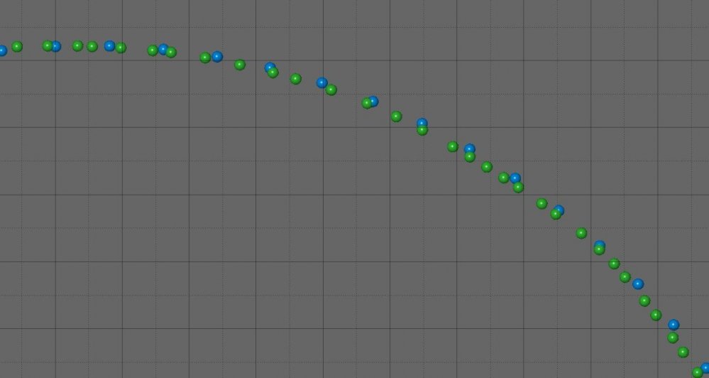

[Ti...] Posted March 17, 2024 Share Posted March 17, 2024 I created a section but and then was able to restore the selection and use a discrete point cloud with all these nice points. Is there a way to export the nominal xy coordinates and the real xy coordinates? I played with the F2 stuff but couldn't come up with extracting the coordinates from each individual point with python. thanks. Link to comment Share on other sites More sharing options...
[Ri...] Posted March 18, 2024 Share Posted March 18, 2024 Hi, here's a loop to access all points of actual section. Replace "Name of section" with the name of your section. for i in range(gom.app.project.actual_elements['Name of section'].num_points): point = gom.app.project.actual_elements['Name of section'].coordinate[i] This refers to actual section, replace "actual_elements" with "inspection" to access nominal section. Inside the coordinate element you have the xyz coordinate that you can access as easily as point.x point.y point.z Link to comment Share on other sites More sharing options...

[Na...] Posted March 18, 2024 Share Posted March 18, 2024 Hi, without scripting you can export a pointcloud as ASCII under export -> geometry. Link to comment Share on other sites More sharing options...
[Ti...] Posted March 20, 2024 Author Share Posted March 20, 2024 Please sign in to view this username. Thanks, I'll check that out. I'm using the script for now, I may need to implement this easier for my co-workers in the future. We are actually using the CT results to analyze the performance of each of our cnc machines and toolpath strategies on some key features. Getting these point cloud points really helped. Thanks again. Link to comment Share on other sites More sharing options...
