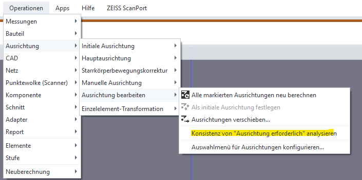

You should get in your export, what you put in your table.
If you dont want information in your export, use table template without this information.
Regarding multible aligments just use the solution you use for other report formats. They should work as well.
For example define the alignment to be used for your elements so you can get them all at once in one table.
