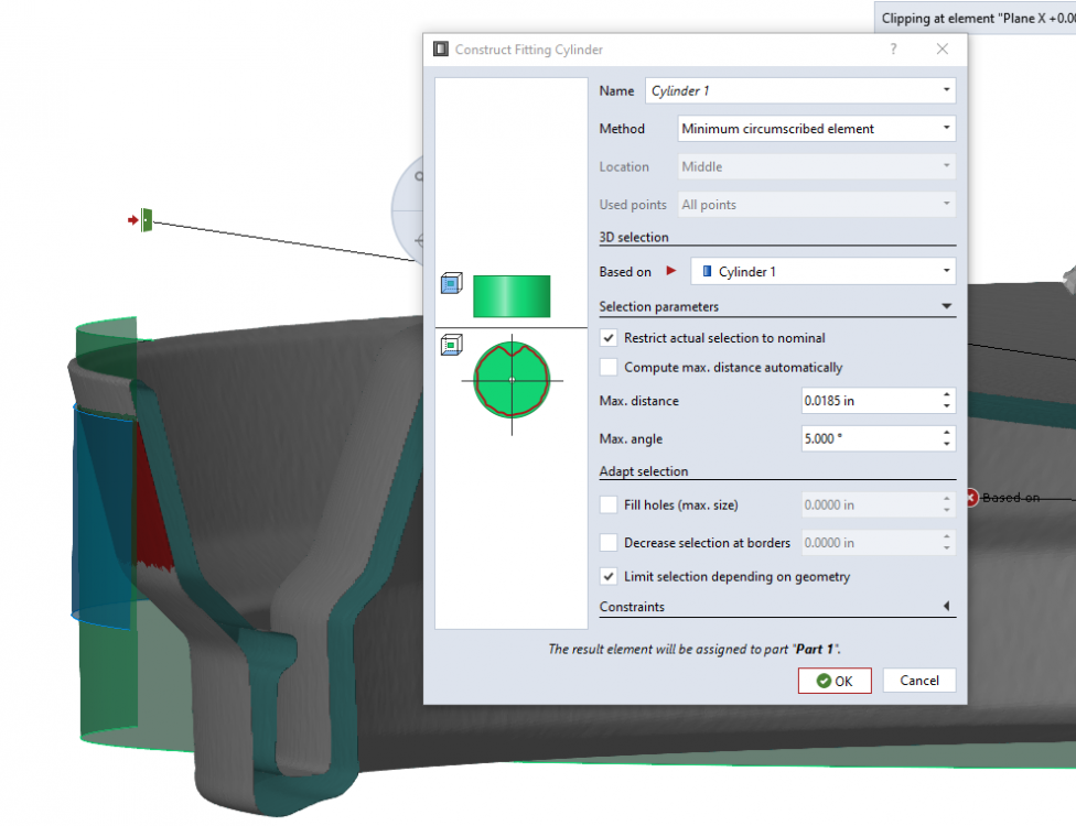

[Br...] Posted March 22, 2024 Share Posted March 22, 2024 I need to find the max OD of this cone (uppermost skirt). First thought after no luck in finding a "max OD of cone", was try Cylinder with the settings below, to no avail. I have resorted to "Distance with caliper" at 0° and 90°, looking at another forum post to try to get the averages, but figure there's got to be a way to achieve this easily, that I'm missing. I have both CAD and scanned mesh in the project, can't even get a measurement on CAD to read as known target for this dimension. Any assist appreciated. Link to comment https://qualityforum.zeiss.com/topic/3828-max-od-of-a-cone/ Share on other sites More sharing options...
[Ti...] Posted March 23, 2024 Share Posted March 23, 2024 Your image is too dark for me to see what the feature is, but if it ends at a plane you can nake an intersection ellipse withthe cone and plane and measure the outer dial of the ellipse. Link to comment https://qualityforum.zeiss.com/topic/3828-max-od-of-a-cone/#findComment-11004 Share on other sites More sharing options...
[Br...] Posted March 25, 2024 Author Share Posted March 25, 2024 Hi Tim, that worked perfectly for what I am trying to do Thanks! Link to comment https://qualityforum.zeiss.com/topic/3828-max-od-of-a-cone/#findComment-11022 Share on other sites More sharing options...
