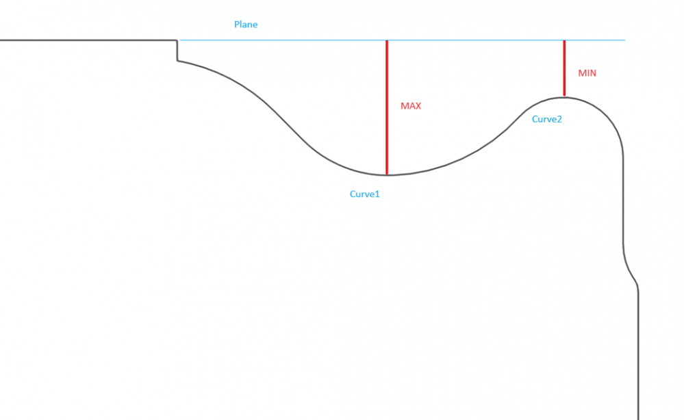

I create a plane, and create 2 curves in a section.
How can I find the max/min distance between them seen in red?

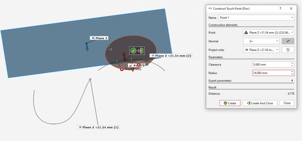

you may create a touch point (disc) on each of the curves. Then create a projected point distance point-plane:

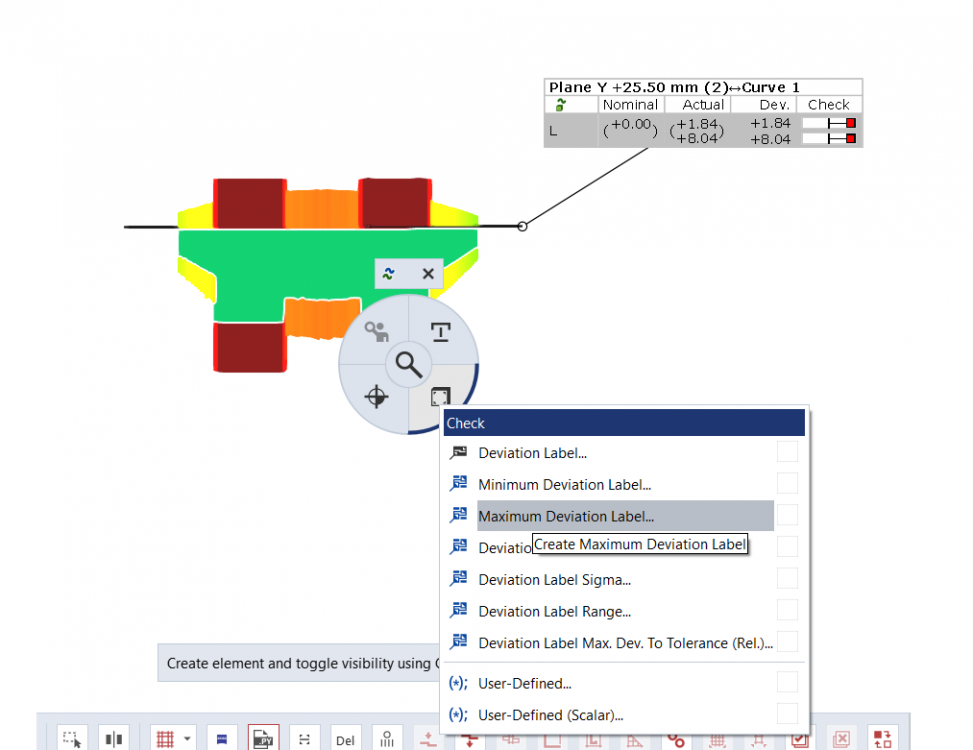

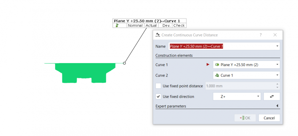

You can create Surface from plane (Triangulate Geometrical Element), after that create two curves from a section. Then create Continuous Curve Distance:
