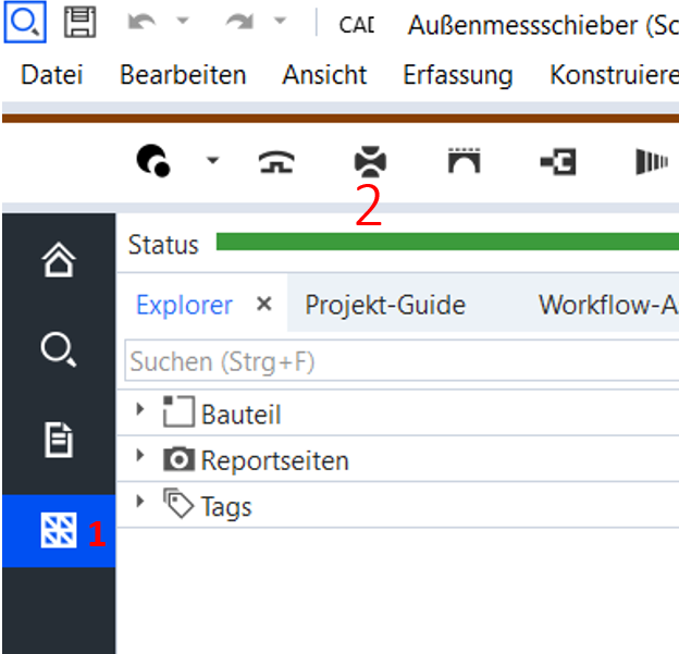

[Ch...] Posted April 9, 2024 Share Posted April 9, 2024 Hello - Does anyone know how to reduce # of trianlges/size of mesh .stl file thru GOM? I have a 3.9 GB underside of a car that a customer cannot open due to size of file. Thank you all very much! Cross-posted Link to comment https://qualityforum.zeiss.com/topic/3867-reducing-of-triangles-in-mesh-stl/ Share on other sites More sharing options...
[An...] Posted April 10, 2024 Share Posted April 10, 2024 Hi Chris, On the left sidebar, navigate to mesh editing and then click on the 3rd symbol in the top section bar. Link to comment https://qualityforum.zeiss.com/topic/3867-reducing-of-triangles-in-mesh-stl/#findComment-11175 Share on other sites More sharing options...
