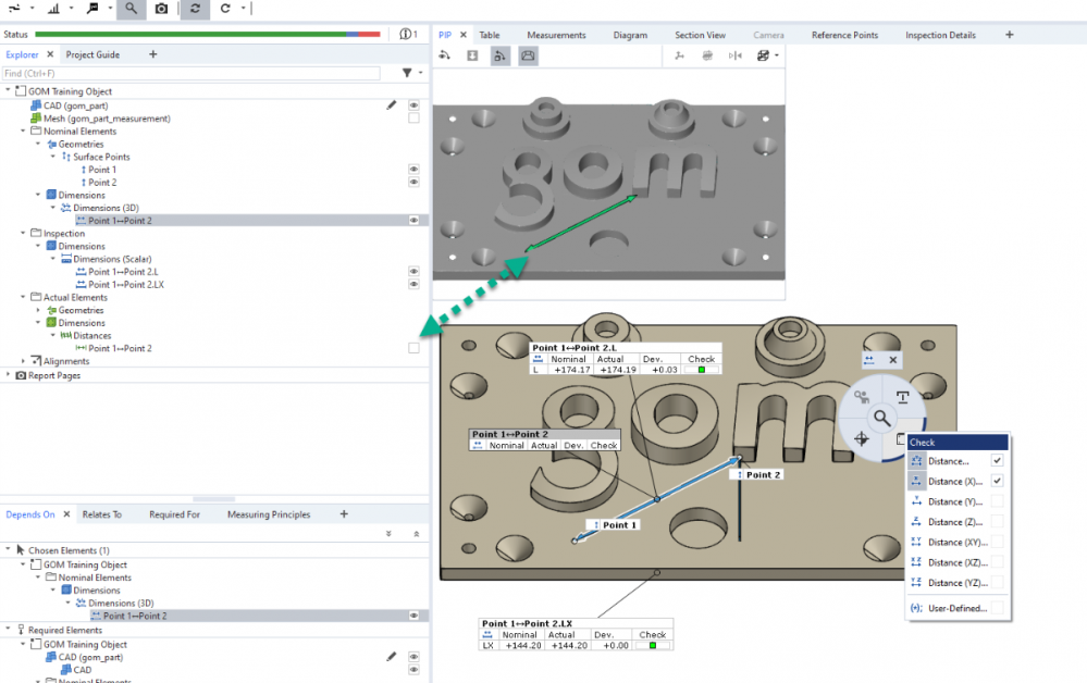

[Kr...] Posted April 15, 2024 Share Posted April 15, 2024 Hello All, I've been working on a project and at some stage all of the dimensions have moved from "inspection" to "nominal elements". This means they are now excluded from exports and It's causing me some issues. I can't figure out how it happened or how to revert them back to "inspection". There are approx. 13k dimensions linked to 33 alignments so I don't really want to recreate them. Does anyone have a fix? or solution? Link to comment https://qualityforum.zeiss.com/topic/3885-dimensions-in-nominal/ Share on other sites More sharing options...
[Na...] Posted April 18, 2024 Share Posted April 18, 2024 Hi Kristian, usually you would create a distance between two nominal points for example -> this will create a nominal dimension. With measuring principle applied you will get an additional actual element derived from the actual elements. A check on the nominal will create an inspection element (like Distance.xyz) in the explorer category "Inspection". So without checking the nominal dimensions/nominal element there won't be an inspection element. Link to comment https://qualityforum.zeiss.com/topic/3885-dimensions-in-nominal/#findComment-11287 Share on other sites More sharing options...
