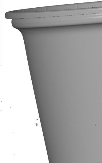

[Br...] Posted April 16, 2024 Share Posted April 16, 2024 Hello all, would like to ask for assist on cleaning up fixture artifacts. I have tried various settings in the "extract volume areas automatically" to clean this up, which does remove some of the larger stuff, but leaves smaller stuff, as shown. Also have tried utilizing "reliable surfaces only" during polygonization, with some success, but still doesn't cover all artifacts. Have taken a few shots at "Refine Mesh" and "Smooth Mesh" as well. I have to manually remove quite a bit of these artifacts after polygonizing, all simply bits of foam fixturing, seems like it should be easily done but I have yet to find the right tool, obviously. Any assist appreciated! Link to comment https://qualityforum.zeiss.com/topic/3887-cleaning-up-noise-from-fixturing/ Share on other sites More sharing options...

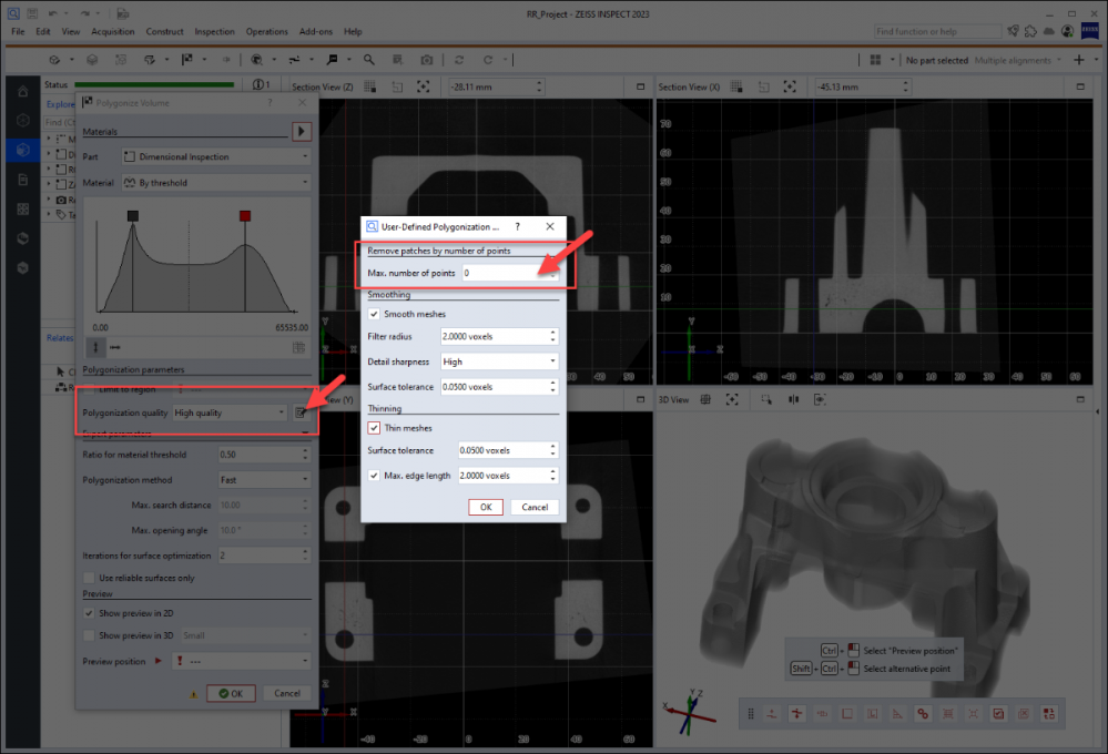

[Lo...] Posted April 24, 2024 Share Posted April 24, 2024 Actually, in the polygonization quality parameters for Volume Polygonization, this exact setting can be configured. There you can specify the minimum number of points per surface patch (connected surface element) shall remain. All geometry patches with less points than the configured threshold will not be put into the final actual mesh. Link to comment https://qualityforum.zeiss.com/topic/3887-cleaning-up-noise-from-fixturing/#findComment-11347 Share on other sites More sharing options...
[Lo...] Posted April 24, 2024 Share Posted April 24, 2024 Choose "Edit" on the Polygonization quality setting and set "Max. number of points" to some value > 0 to remove smaller particles. Link to comment https://qualityforum.zeiss.com/topic/3887-cleaning-up-noise-from-fixturing/#findComment-11349 Share on other sites More sharing options...
