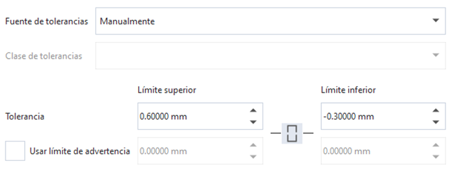

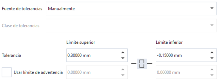

[Ir...] Posted April 23, 2024 Share Posted April 23, 2024 Good morning, Is it possible to introduce a variable tolerance based on whether a condition is met or not in another feature? For example, we want feature C to have tolerances of +0.6 and -0.3 in case feature A falls within its tolerances, as shown in the following image: In case feature A does not fall within its tolerance limits, the tolerance assigned to feature C would be +0.3 and -0.15, as shown in the image below: Is there any way to condition the value of the tolerance of the feature C to achieve this? Link to comment https://qualityforum.zeiss.com/topic/3913-variable-tolerances/ Share on other sites More sharing options...
[Se...] Posted April 24, 2024 Share Posted April 24, 2024 Good morning, This is not supported yet. It is recorded as a wish, but can not tell a specific release when it will be available. As a workaround, it is possible to create a user define check (see ZEISS Quality Tech Guide) that has fix value on the tolerances, but changes the results dinamically based on the results of the other distance -> instead of halbing the tolerance, the result value can be doubled. Hope this helps Link to comment https://qualityforum.zeiss.com/topic/3913-variable-tolerances/#findComment-11341 Share on other sites More sharing options...
