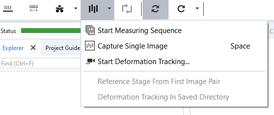

[Ch...] Posted April 26, 2024 Share Posted April 26, 2024 Is there a way when creating a workspace in an add-on to have a drop-down menu item? Adding workspaces to add-ons — Add-On Documentation (zeissiqs.github.io) Something like the Measurement dropdown: How do we write the description of a folder? "workflow_commands": [ "sys.import_file", "[separator]", "userscript.Blade_CMM__ProjectSetup__Project_Setup", "inspect.tb_create_blade_stylus_correction_cmd_group"] Link to comment https://qualityforum.zeiss.com/topic/3921-adding-workspaces-%E2%80%9Cworkflow_commands%E2%80%9D-drop-downs/ Share on other sites More sharing options...

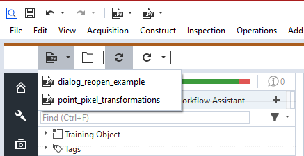

[Ma...] Posted May 2, 2024 Share Posted May 2, 2024 Hi, Maybe this is not a general solution, but it works for Add-on scripts. Add a group of scripts (which are located in a common folder) to the Title Toolbar to view the naming of a group: View->Screen Setup->Toolbar... In the Edit Toolbar dialog Select "Title Toolbar" from the dropdown widget In the table below (with the entry [...]): RMB->Add Script Group Add a folder containing your scripts - I am using "misc" from the "Python API Examples" Add-on for demonstration here The toolbar entry is named "userscript.group_PythonAPiExamples__examples__misc" (double underscore is used as folder separator) Add this group entry to your workspace JSON file, e.g. ... "workflow_commands": [ "userscript.group_PythonApiExamples__examples__misc", "sys.import_file" ], ... After restarting ZEISS INSPECT, the group appears in the workspace toolbar: You can replace the generic script icons by specific ones in the scripts' properties dialog (Add-on Explorer). Hope this helps! Best regards Matthias Link to comment https://qualityforum.zeiss.com/topic/3921-adding-workspaces-%E2%80%9Cworkflow_commands%E2%80%9D-drop-downs/#findComment-11391 Share on other sites More sharing options...
