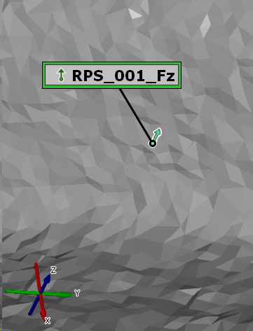

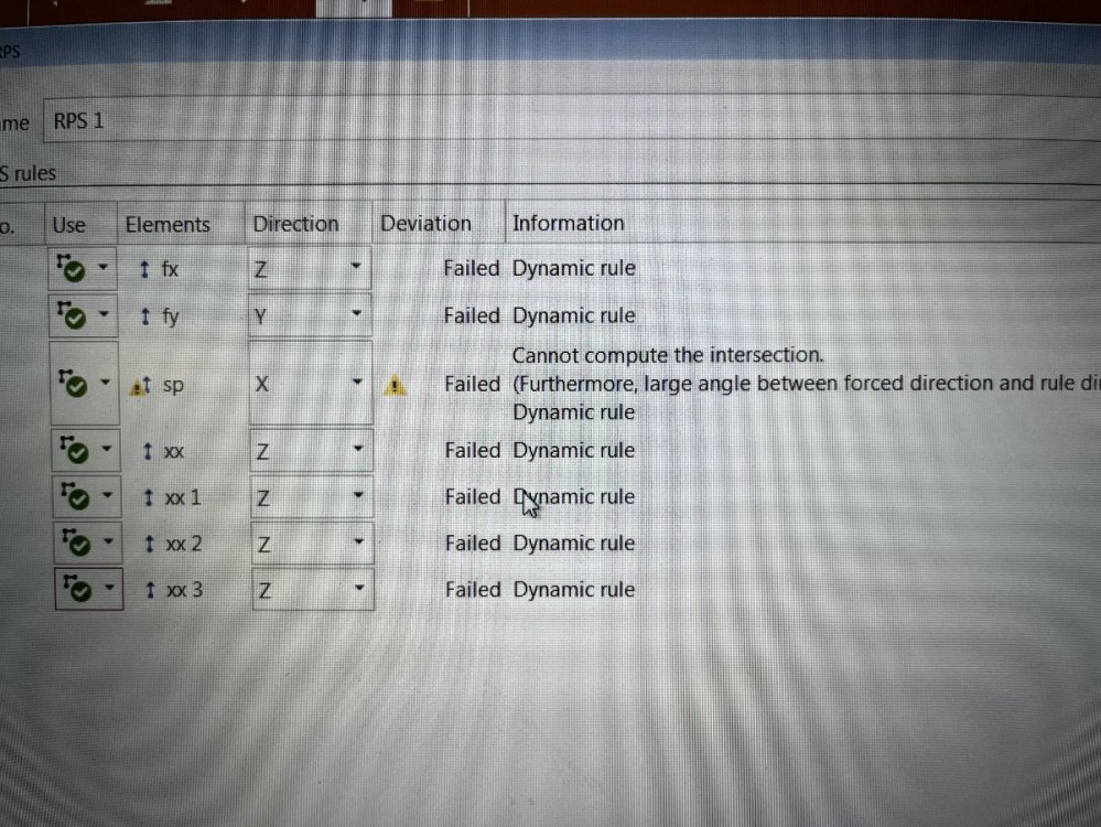

[Jo...] Posted May 7, 2024 Share Posted May 7, 2024 Hello everyone, I am having issues with RPS alignment, based on initial prealignment. The surface points have have been selected on a solid shape and the measuring principles have been added. When it comes to selecting the RPS points the effective directions are automatically selected (see below). The plausibility check fails and the final step of the RPS alignment shows the deviation failed. I would like to know how to resolve this? Regards, Jo Link to comment https://qualityforum.zeiss.com/topic/3951-issues-with-rps-alignment-and-plausibility-check-failed/ Share on other sites More sharing options...
[Ma...] Posted May 7, 2024 Share Posted May 7, 2024 Look at the "sp" measured point (the point on the mesh): you have to use it in the X direction, but it seems the measured one has taken in other direction. If the point is in the right position, simply remove the plausibility check, in other case you have to look at the position of the sp point if you have to move it. Link to comment https://qualityforum.zeiss.com/topic/3951-issues-with-rps-alignment-and-plausibility-check-failed/#findComment-11423 Share on other sites More sharing options...

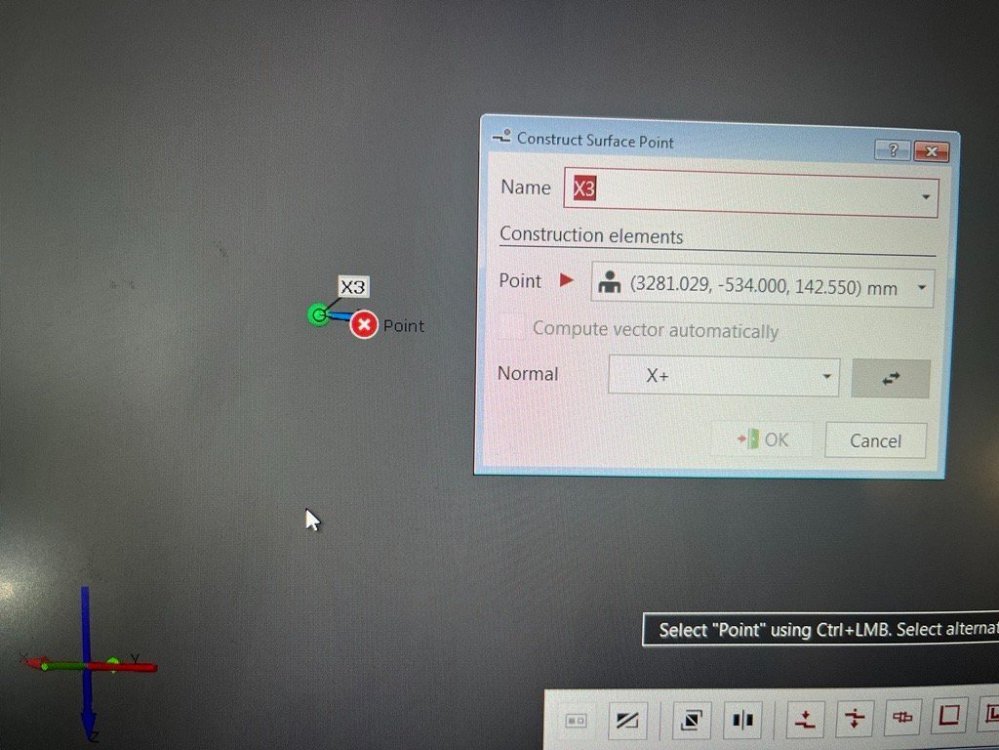

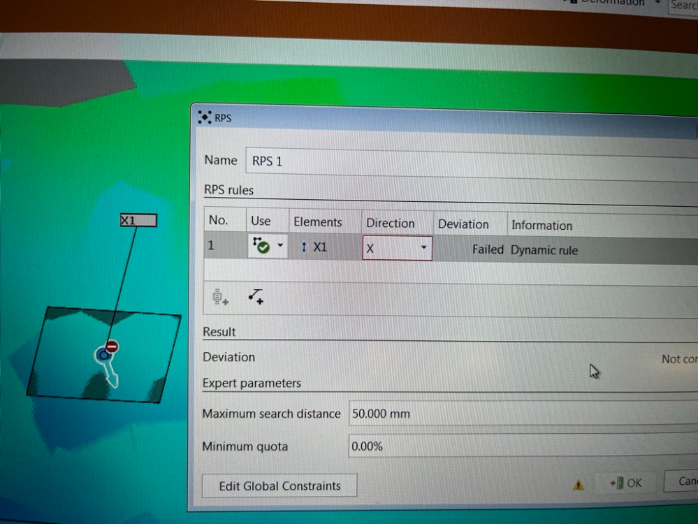

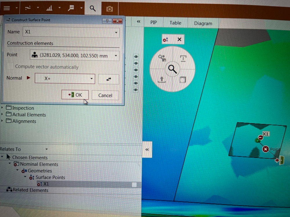

[Jo...] Posted May 10, 2024 Author Share Posted May 10, 2024 Please sign in to view this quote. Pre-alignment has been done so when carry out RPS alignment issues with allocating points. Aware in image there's no enough points, just to highlight the issue -> deviation: failed / dynamic rule. I've tried all directions with no luck. Link to comment https://qualityforum.zeiss.com/topic/3951-issues-with-rps-alignment-and-plausibility-check-failed/#findComment-11464 Share on other sites More sharing options...
[Ma...] Posted May 13, 2024 Share Posted May 13, 2024 You have to post the image of the measured point on the mesh with the coordinate system, like this. , so I can see if the measured point have had some problem during measurement. Link to comment https://qualityforum.zeiss.com/topic/3951-issues-with-rps-alignment-and-plausibility-check-failed/#findComment-11476 Share on other sites More sharing options...
