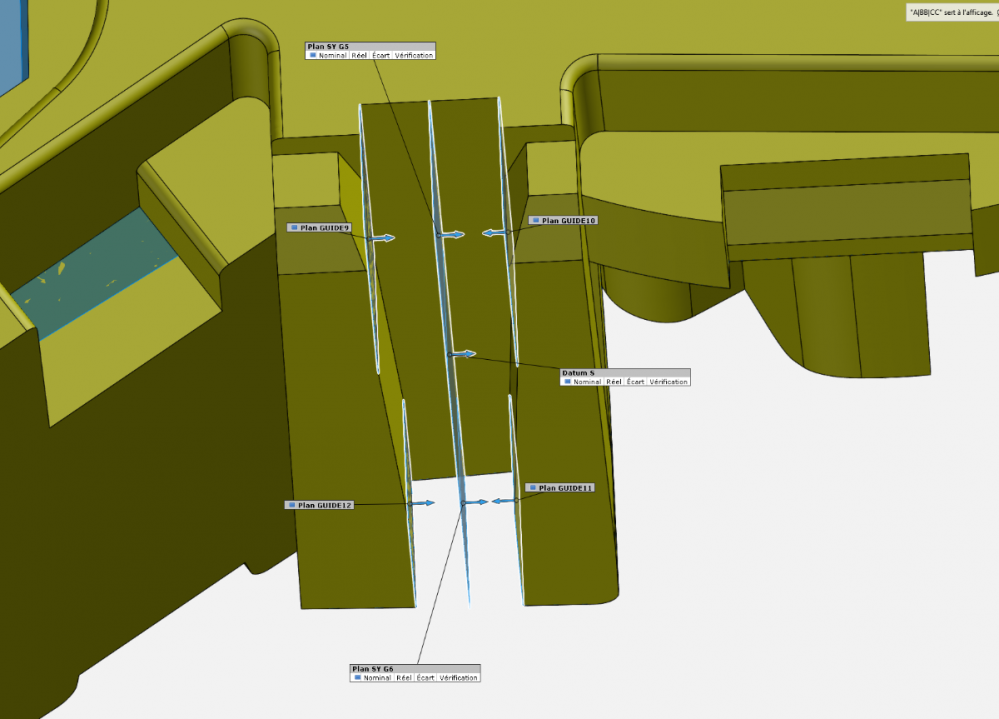

[DR...] Posted September 1, 2021 Share Posted September 1, 2021 hello , how can I select all the point of the symmetry of two symmetry planes ? I need it to measure the perpendicularity thank you! Link to comment https://qualityforum.zeiss.com/topic/396-the-symmetry-of-two-symmetry/ Share on other sites More sharing options...
[DR...] Posted September 1, 2021 Author Share Posted September 1, 2021 Please could you help me ? how can I inspect the symmetrical plane of two symmetrical planes ? Link to comment https://qualityforum.zeiss.com/topic/396-the-symmetry-of-two-symmetry/#findComment-1162 Share on other sites More sharing options...

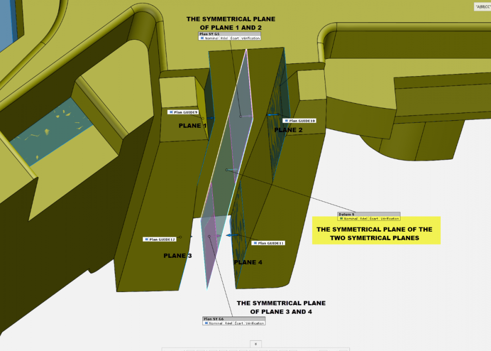

[DR...] Posted September 2, 2021 Author Share Posted September 2, 2021 Hello Mr Nanno I want to measure the perpendicularity of the datum S . --> Datum S is the symetrical plane of the two symetrical planes (see pictures please). thank you in advance for your help ! Link to comment https://qualityforum.zeiss.com/topic/396-the-symmetry-of-two-symmetry/#findComment-1171 Share on other sites More sharing options...
[DR...] Posted September 2, 2021 Author Share Posted September 2, 2021 Hello, I can't create a fitting plane from anny symmetrical plane .Although, I can measure the perpendicularity of the two symmetrical planes (of plane 1 and 2) &(of plane 2&3) . thank you Link to comment https://qualityforum.zeiss.com/topic/396-the-symmetry-of-two-symmetry/#findComment-1172 Share on other sites More sharing options...

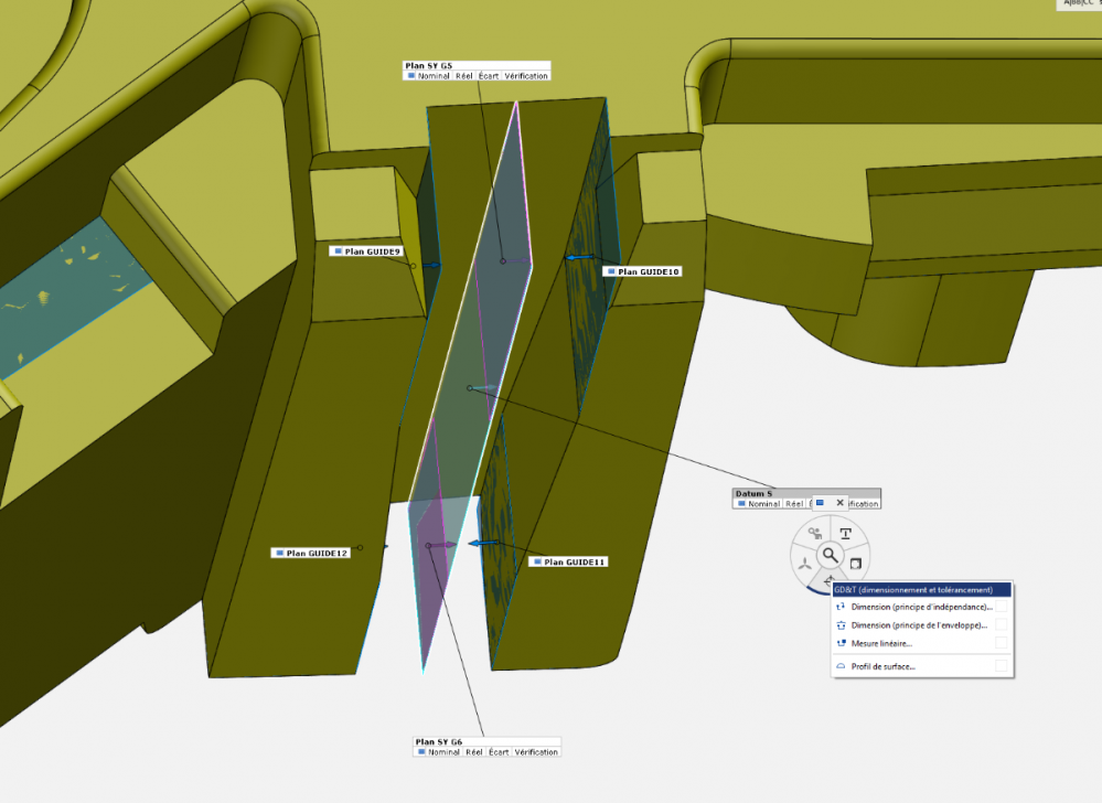

[Ch...] Posted September 2, 2021 Share Posted September 2, 2021 Hello, this seems to be a CZ evaluation of two symmetric planes. If I am correct, such evaluation is possible starting with GOM Software 2021. Simple create your two symmetry planes, put them (to be exact the nominal one) into one element group and choose perpendicularity on the element group. Hope this helps. Christoph Schult Link to comment https://qualityforum.zeiss.com/topic/396-the-symmetry-of-two-symmetry/#findComment-1173 Share on other sites More sharing options...

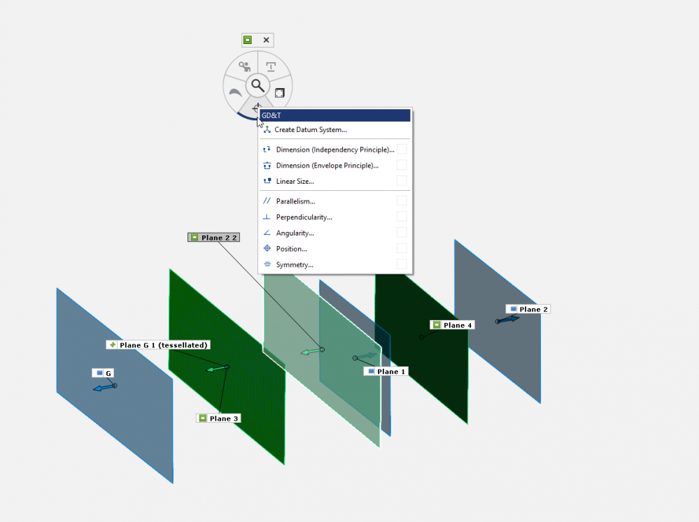

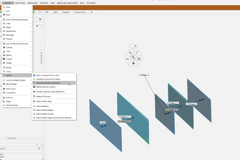

[Na...] Posted September 2, 2021 Share Posted September 2, 2021 Hello, first, you have to tesselate (I wrote wrongly "triangulate" in the post before) the two actual symmetrical planes. Construct -> Surface -> Tesselate geometric element. This will create a surface and you have to construct a fitting plane on these surfaces. The symmetrical plane of the fitting planes on the tesselated surfaces have a point selection so the check can be applied. It is still a workaround, though and not according to a standard. Regards, Nanno Link to comment https://qualityforum.zeiss.com/topic/396-the-symmetry-of-two-symmetry/#findComment-1175 Share on other sites More sharing options...

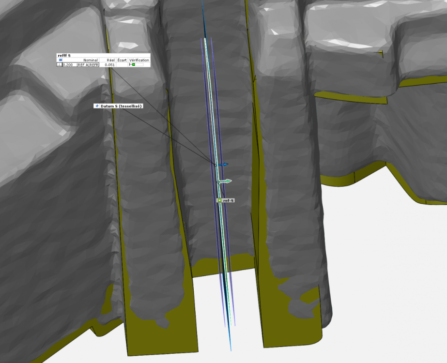

[DR...] Posted September 2, 2021 Author Share Posted September 2, 2021 Mr Nanno ; thank you very much .it's work but why it's not according to a standard. I checked the to plane (the original symetrical plane and the tessellated one) they are in the same position . thank you ! Link to comment https://qualityforum.zeiss.com/topic/396-the-symmetry-of-two-symmetry/#findComment-1176 Share on other sites More sharing options...
[Di...] Posted September 6, 2021 Share Posted September 6, 2021 Hello, In the GOM Software 2021 there is no need to tesselate elements to be able to inspect such situations. Too complicated and not necessary. To me this looks like a pure Combined Zone requirement and this can be handled as standard compliant check inside the GOM Software 2021. Create the 2 symmetric planes with I-Inspect -> GD&T Quick Creation -> Perpendicularity. Select both planes and then right click and select Create Element Group. Inside of the perpendicularity dialog you will find the CZ activated. Set the needed parameters for the tolerance and click on OK. That's it. Link to comment https://qualityforum.zeiss.com/topic/396-the-symmetry-of-two-symmetry/#findComment-1187 Share on other sites More sharing options...
