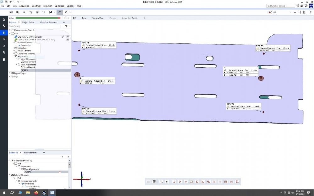

[Wi...] Posted May 15, 2024 Share Posted May 15, 2024 Good Day Everyone I have run into a spot of trouble while scanning blanks for our parts. After scanning and polygonize the mesh keeps flipping 180 degrees on the z-axis. On pre-alignment I have played around with the time length required for alignment. So the results was Short:No Alignment, Normal:Alignment (Flipped), Long:Alignment (Flipped). Tried giving it a reference point on nominal and actual, Result:No Alignment. I have also tried a Manual Alignment Rotation, This also resulted in No Alignment. Best Fit Alignment also result in an upside down alignment. Attached is a screen shot showing the mesh upside down on the CAD. If anyone has experienced this and found a solution, please share. I will also be happy for a link if this issue was addressed before. Regards Willem v Zyl Link to comment https://qualityforum.zeiss.com/topic/3976-alignment-mesh-flipped-on-axis/ Share on other sites More sharing options...
[Na...] Posted May 15, 2024 Share Posted May 15, 2024 Hello Willem, you could try to create a nominal patch compound of only one side of the CAD and define it as target element in the prealignment dialog. For symmetric or rotational symmetric parts scanning in a defined alignment might help. A manual 3-Point alignment will let you set the inital alingment manually, but scanning in a defined coordinate system would be a nicer solution. Nanno Link to comment https://qualityforum.zeiss.com/topic/3976-alignment-mesh-flipped-on-axis/#findComment-11506 Share on other sites More sharing options...
[Wi...] Posted May 15, 2024 Author Share Posted May 15, 2024 Good Day Nanno Thanks a million. Had to wrap my head around the nominal patch compound, but it worked like a charm. Kind Regards Link to comment https://qualityforum.zeiss.com/topic/3976-alignment-mesh-flipped-on-axis/#findComment-11512 Share on other sites More sharing options...
[龙...] Posted May 27, 2024 Share Posted May 27, 2024 Attempt to establish three coordinate reference planes and use geometric feature alignment for matching and alignment Link to comment https://qualityforum.zeiss.com/topic/3976-alignment-mesh-flipped-on-axis/#findComment-11588 Share on other sites More sharing options...
